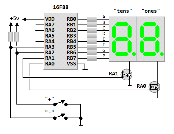

You have all you need to make one on the page I posted all you have to do is change the code Mike posted to work with your chip.
Look at post4 its for a 16F88 it's still asm and it will work with some changes on your chip
Now is your chip really a 16F887 or a 16F877a there is no 16F887a.
OP might be multiplexing the displays to reduce I/O pin requirements. Using "direct drive" from I/O pins could provide about 20 ma 'peak' current or about 10 ma 'average' current to each display segment at a 50% duty cycle which should be pretty bright.
2-digit-up-down-png.30263
Hundreds of ways to do the software. OP might consider using one big isochronous loop or perhaps use an ISR (interrupt service routine) to refresh the displays as a background task.
I'm surprised OP couldn't find any 2-digit 7-segment up/down counter examples on the Internet.
Kind regards, Mike

A quickly thrown together (untested) isochronous loop program example;
;  2-Digit Up/Dn Counter, Isochronous Loop Example                *
        processor PIC16F88
        include "p16f88.inc"
        errorlevel -302
16f877a..
what do you mean on the changes on my chip?..
won't i need to change the program?..
Lol all you had to do is this and test it.
Look it over real good
; change the chip name and configure
      list		p=16f877A	; list directive to define processor
	#include	<p16f877A.inc>	; processor specific variable definitions
	__CONFIG _CP_OFF & _WDT_OFF & _BODEN_OFF & _PWRTE_ON & _HS_OSC & _WRT_OFF & _LVP_ON & _CPD_OFF

Wire it up to the same pins as the picture
This is a 16F88 but your chip has the same ports PORTA and PORTB
This Is Mike K8LH Work I just reposted it to help you out and changed code to work with your chip.
it's not working.. :(
Hi AnnaMaj,
Post the changes you have made to the code then we can see where you have gone wrong.
Can you describe in a little more detail what you have done to determine that?
Here are some thoughts:
1) Is that conclusion based on a breadboard circuit or simulation?
2) What simulator are you using?
3) Bypass the delays (comment out) and step through the rest of the program. What happens? Post the code from your simulation.
4) If you are not using a simulator, such as MPLAB SIM, it is difficult to troubleshoot code.
5) If breadboard, is anything happening? That is, is it totally dead, or are some led's coming on, but they are not quite right?
6) Is the code you posted a copy and paste of your actual Assembly code or simply copied from what's been posted here? In other words, it is crucial to determine whether some unintentional changes have slipped into the code you are using.
7) I haven't had breakfast yet, but I don't see the HS crystal resonator in your schematic. See Chapter 14.2 of the datasheet.
The above list is not exhaustive.
John
hi AnnaMaj
It works for me in the Oshonsoft simulator.:rolleyes:
E
She or he may not be using the right crystal mikes code
Was for a 16f88 at 8 MHz
I changed the code to run on a 16f877a you need a crystal on that one
May of left crystal out but I'm sure the code works
John
this is based on simulation (ISIS)..
sorry cause im new in this and i still dont know much.. thats y i need help..
i dont still dont understand much.. :(
do i still need to change the codes?
It works on hardware with a 8mhz crystal. That is how i tried it dont like ISIS.
