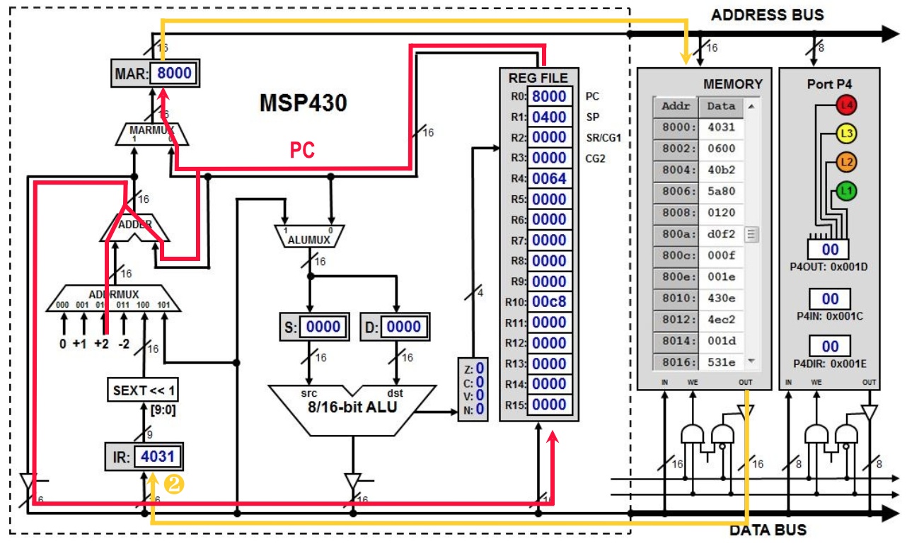

I have uploaded circuit, I need some information.
If I am wrong somewhere please correct me
circuit contain mainly three part RAM, ROM, I/O port
memory - that means Rom where data and address is stored ?
reg file- that means Ram where the address of data is stored ?
If switch is connected to port P4 pin 1 (input)
and LED is connected to port P4 pin 2 (output)
code is burned in to the memory of controller (ROM)
Q1. when power is on, what is first step for microcontroller I mean first what do the microcontroller .
which circuit of microcontroller does work first ROM, Ram , I/o device
Processor take information from I/O devices
processor take information from RAM
processor take information from ROM
Q2. how does processor know that port Ppin 1 is high or low I mean how the ROM , RAM I/o device and processor work together ?
Q3. Is it correct?
fetching - control unit take information fro rom
decode - decoder take the information and send to processor
execute - processor do the operation. store result somewhere , I don't know where ?

Q1: Some things happen asynchonously or without the clock. Power-up resets certain states. That;s usually the job of the NOT RESET pin. Thats how ports get initialized to their default state. RAM generally powers up in a random state.
In modern processors there may be a short time to connect via JTAG or to download the firmware.
Nonetheless, a branch is started to a specific location depending on the architecture. It could be a branch to location 0. In a PDP-11 it's a branch to 173000 or 773000 octal.
The specific processor determines exactly what happens.

I think I have to do more study but I have little doubt please correct
fetching - decoder take instruction from rom memory
decode- decoder decode instruction ans send to the ALU
execution-ALU do simple operation like ADD , mov, and result Save into Ram memory
program counter execute Instruction one by one
Fetch - get instruction somehow. The method isn't important, that's why we call it Fetch.
Decode - What kind of instruction is this?
Execute - Do whatever the instruction requires. It may not be one thing.

Every computer, controller implements the Fetch, decode and Execute in various ways.
One concept that is important in this study is the CISC and RISC architecture. CISC means Complicated Instruction Set Computing and RISC means Reduced Instruction Set Computing. In the latter, each instruction generally required one clock cycle to execute and the instructions are simple.
To give you an idea of a really CISC computer, lets look at the VAX architecture. You can find a character with a machine instruction. See: https://www.cs.auckland.ac.nz/references/macvax/op-codes/Instructions/locc.html
So, your definition falls out the window. With Fetch, Decode and Execute abstractly defined, it still is valid.
