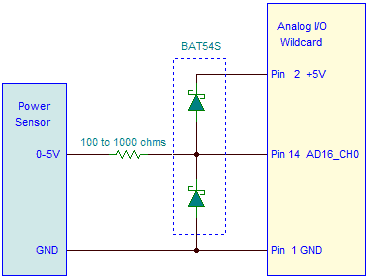

For ADC input protection, put a low value resistor (470R?) in series with the pin, move the filter cap to the pin side the resistor & add two schottky diodes from the pin to 3.3V and ground, with cathodes towards the 3.3V supply. They will limit any over or undervoltage.

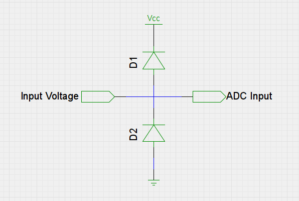

I'm using 10k Ohm pots. I think I should consider the diode solution, to protect over AND under voltage as you said. Does it matter what kind of Schottky diode? I've never used those in a circuit before.
Some info I found:
And from mosiac-industries website.
Thank you for this input. Been researching ways of protecting the analog input, as you have mentioned with diodes.
Some info I found:
Generally micro-controllers already have built-in diodes on the I/O pins, for this exact reason. You should however, add series resistors to limit current through the diodes, either the internal ones, or external ones if you add them.

I think this might be one valid solution for protecting an analog input from over and negative voltages. Analog input pin (pin 17). Just need to determine the values of the Schottky diodes to use. (The jack J11 will receive a CdS resistive photosensor whose resistive value would be added to that of the pot VR3, (when switched on by S3). C3 is a ceramic 0.1uf cap.
I could omit the Schottky diodes, however, I will make them optional in order to see the difference in the circuits behavior, with and without diodes.
There should be no difference in the circuits behaviour, as they have no function UNTIL you try and provide too much voltage to the input.

The 470 ohm should make no difference, and I would prefer to see it higher - although I'm not sure what the input spec. of your processor is?.
The main issue is that there's only one A2D in the processor, and that is switched between the different inputs - and as you switch the internal sample and hold capacitor has to charge/discharge to the new voltage level. If you switch too quickly the capacitor doesn't have time to charge/discharge fully (dependent on the source impedance), and you get incorrect readings.

You should ALWAYS include a resistor in series, to limit current through the protection diodes. Bear in mind, if the input is above Vdd the internal protection diode will bypass the voltage to the Vdd rail, but with the tiny amount of current PIC's often use that voltage could exceed the safe voltage for the PIC. Also, if you remove power to the PIC, it could continue running is a voltage is connected to the analogue input.
