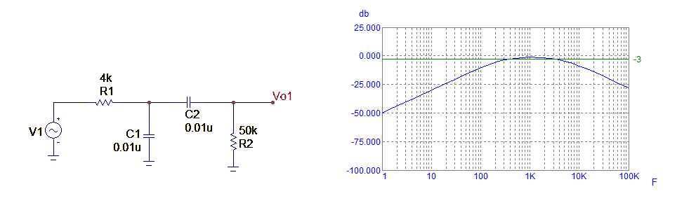

Hi again,
Here is a sample circuit that does the bandpass function. You can try this and see if you like it.
The response curve is shown to the right of the circuit. You can see the -3db points occur at about 350Hz and 3500Hz.

Hi again,
Thank you for ge example. We will try this out and see how it goes.
Sure, but note that the frequency points are approximate so the band span may be more like 300 to 4000Hz. If you want more accurate settings we could change the values a little.
