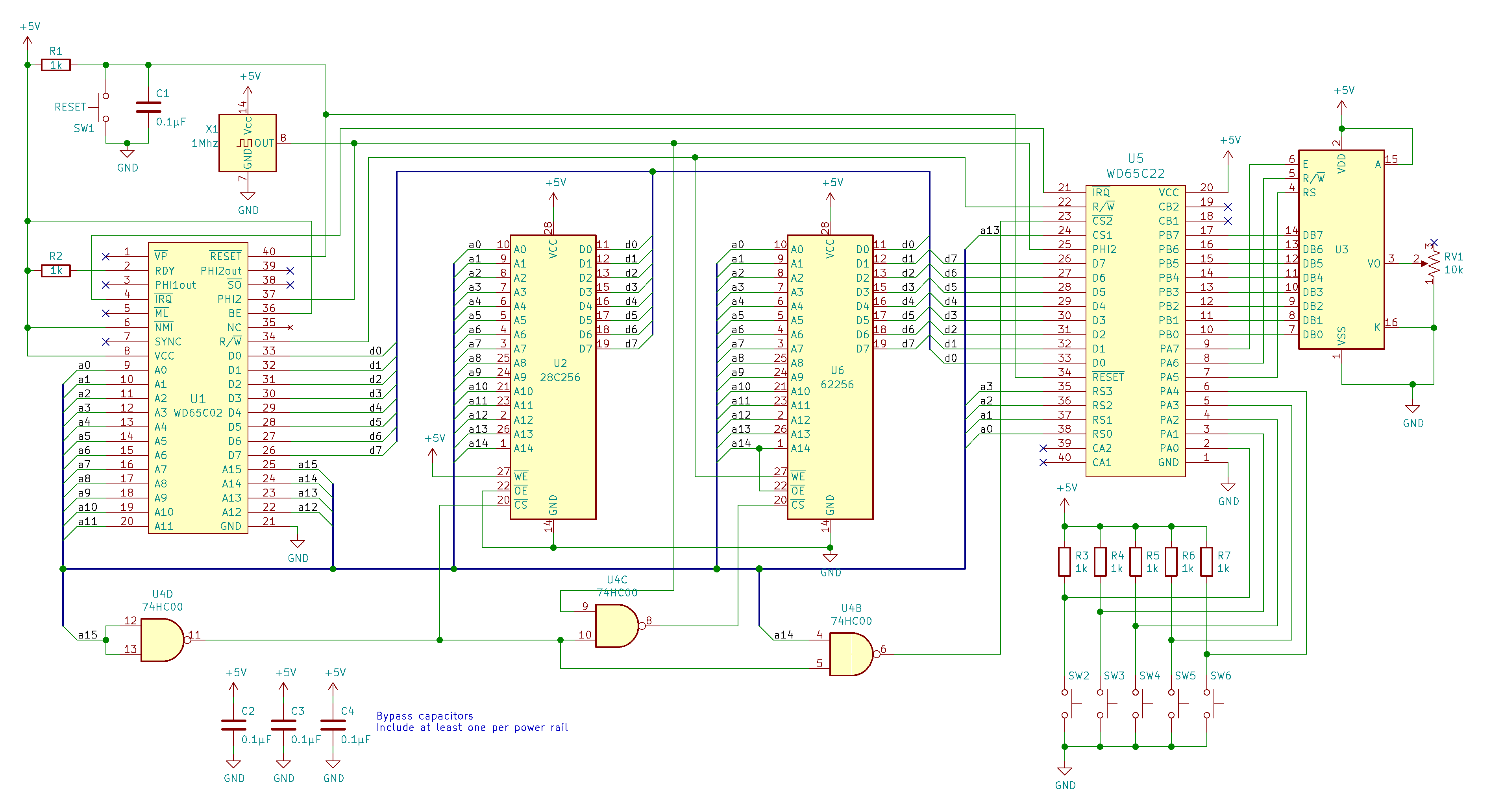

The circuit below is for a modern 6502 SBC (Small Board Computer), and is pretty well the minimum you can get away with, as I said before an 8086 is a much cruder device, and requires considerable more chips to make a minimum working system. A Z80 based SBC is fairly similar to a 6502 version.
