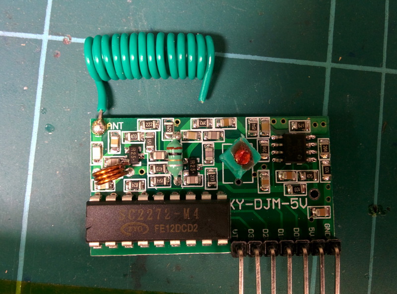

Hi all, I'm using some of these for a project **broken link removed**

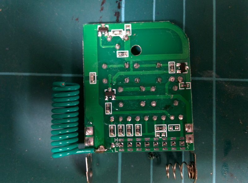

I have two sets, one came with no antenna on the RX module and the other came with a coiled up piece of wire. I have tested them and the one with no antenna has a poor range. I made one to pretty much the same size as the module that came with one and it worked.
I have removed the telescopic antenna from one of the TX modules and replaced it with another antenna, the same as I made for the RX and it seems to work OK with a fair range.
My question is really how do I get the best out of these modules - would a bigger antenna (i.e. a longer bit of coiled wire) give a better range or is there a science to using the correct antennas?
Thanks in advance!

they are certainly pretty cheaply made. They seem have 1 chip that does the encoding / decoding. So it may be a case of having the antenna on the rx as big as I can fit in?

What you're basically aiming for is a quarterwave whip, which is 16.5cm for 433MHz.
But it's likely to be something short of that, depending what can fit in - and coiling it up greatly changes things - but it's really not critical for short range devices like these.
It does not have a crystal but instead it has a trimmer capacitor with red nail polish on it.

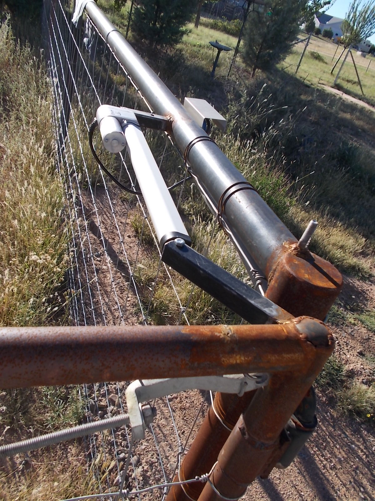

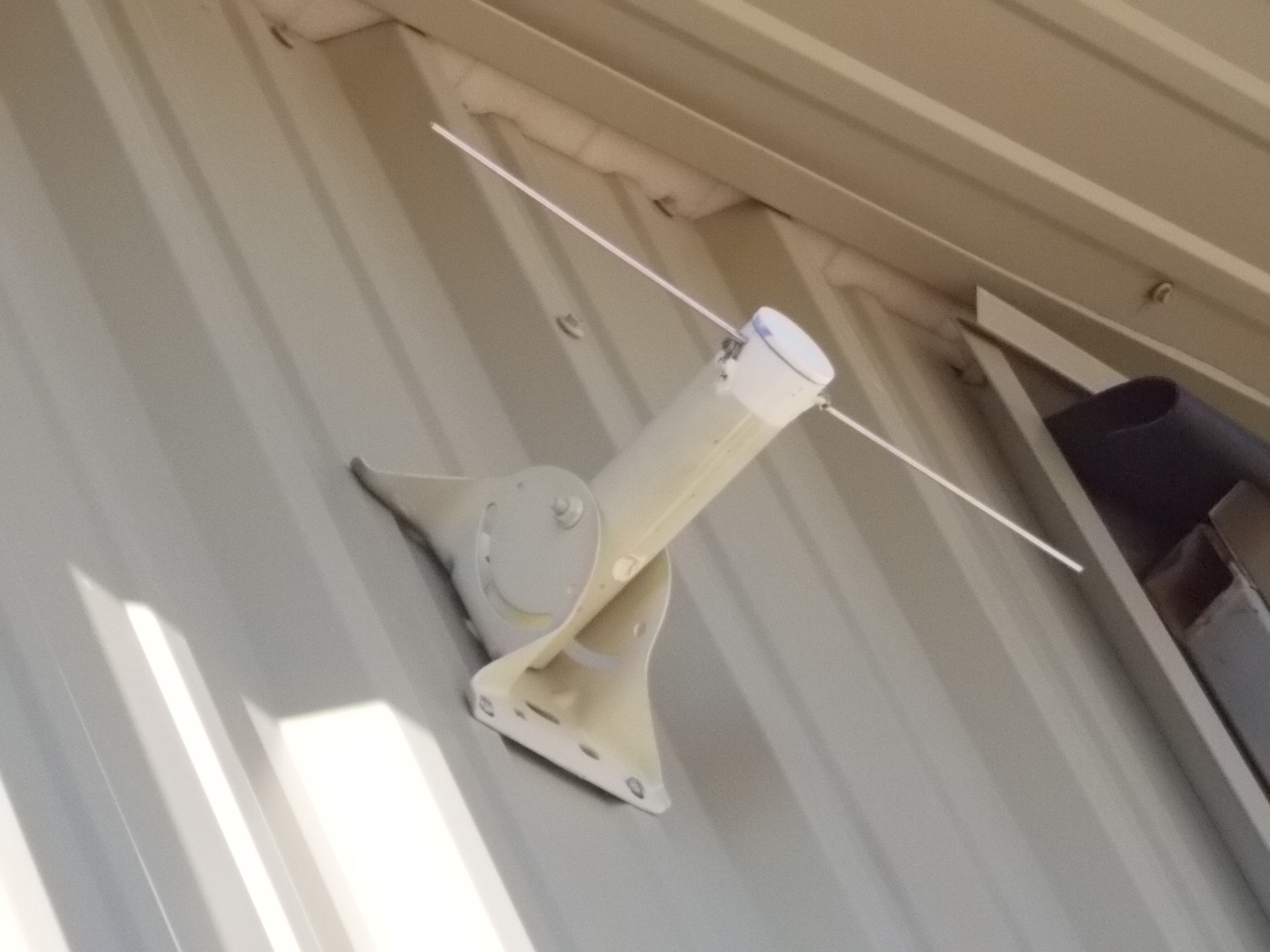

Back to the 315/433MHz ISM modules: folks that buy these come here to ask how to extend the range. It is really simple; put proper antennas on them. Works for me. I am using those same (315MHz) EBay modules to open my garage doors and my motorized swing gate. The secret to getting more than 300m (1000ft) range in open air is the receive antenna. I am using a full-length 1/2λ dipole mounted up high on the outside of my metal aircraft hangar.

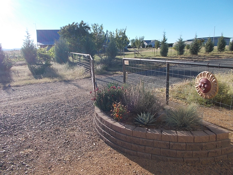

Actually, not the garage doors, but the drive-through swing-gate. The actuator I am using takes about 30sec to move the gate from closed to open, so if I send the command from about 1000ft away, the gate is open by the time I drive up to it...
Nice, but have you considered a lick of paint? :D
Looks a pretty big place though - and a bit dry?.
The style here is to let pipe rail fences just turn rusty. In northern Az, it doesn't rain much; about 20in per year. I am located not too far from Sedona and Prescott.
