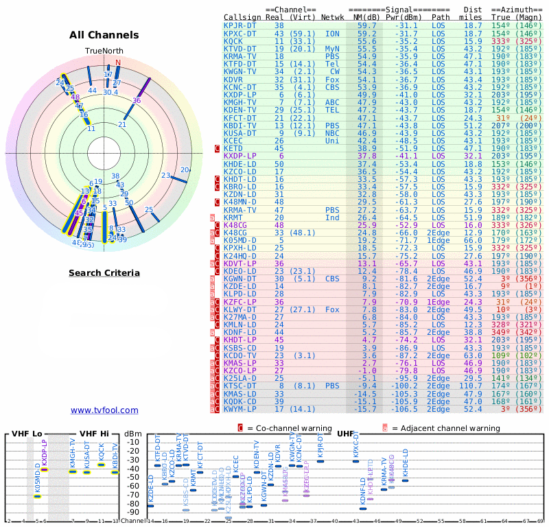

I went to www.tvfool.com, for US maps. Here is a list of how far, what direction, how strong....
I have a very old antenna facing south and a little west. I want to try facing NNE and see what I can get.

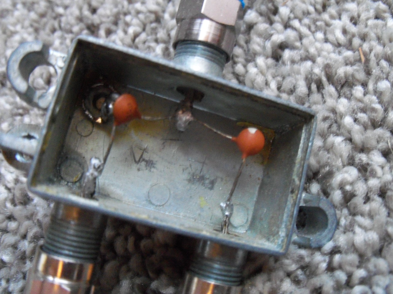

T combiners are not all the same test several see which 1 works best for you. T combiner in picture works best for ME but maybe not for you test several. The 2 caps are both 5 pf.

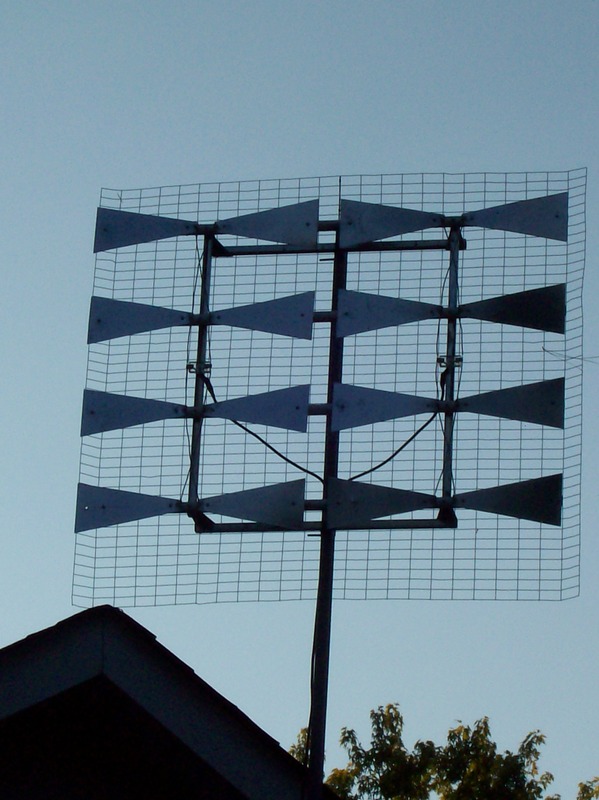

1 more thing, 8 bay antenna in the picture the reflector screen has 1" x 2" holes in the screen. Smaller holes work better for higher frequency. 1" x 1" holes will work better. 1/2" x 1/2" holes are even better especially for a channel that is hard to receive. Your antenna needs to be tuned to all the frequencies you want to receive. Reflector screen is 48" x 48".
Solid metal bow ties work much better than V shape wire bow ties. I used roofing aluminum.
If you buy a CM4228 or DB8 you can make improvements for better reception or scratch build your own antenna.
