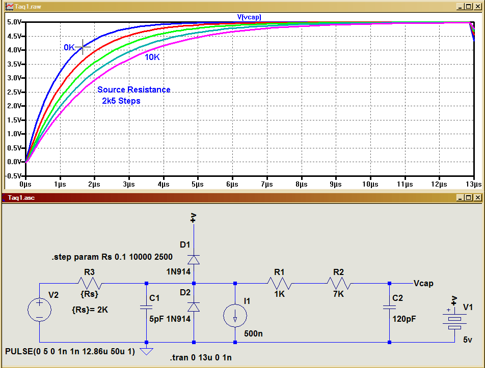

The charge time of the internal capacitor from the external source is determined by the series resistance.
To ensure that the internal capacitor fully charges during the acquisition time of the adc the external resistance has to be less than 10K or so.

This is a simulation I did last year, for a PIC, shows the effect of the source resistance.
The circuit is based on the PIC datasheet.
