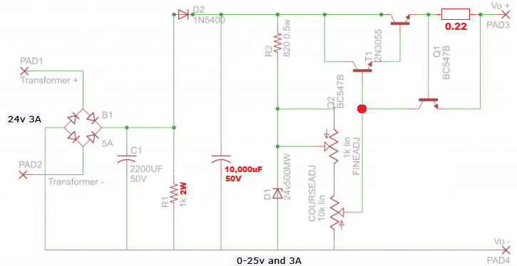

I created a new one. Is this capable of my producing my desired output 0-25v and 3A with a transformer of 24v 3A.
Is its voltage regulation good enough since it has no error amplifier and no negative feedback?
1) The 24V zener voltage increases when it gets warmer but the transistors' voltage decreases to cancel it.
2) The output voltage drops as much as 1V when loaded with 3A.
3) The current-limiting transistor Q1 will blow up then the 11 ohms will reduce the output voltage a lot when there is a load.
I will fix it in half an hour.
OK, my half hour is gone, sorry for the delay.
I fixed the current limiter but the poor voltage regulation remains.
I cannot add contrast to your pastel schematic until the postman comes with a gift from Chemelec.

Is the poor voltage regulation of your voltage regulator good enough for your application?

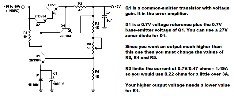

There are hundreds of voltage regulator designs in Google and hundreds of voltage regulator ICs with datasheets showing schematics for them.
They all use an error amplifier with negative feedback so if a heavy load increases the output current which tries to drop the output voltage then the error amplifier senses the voltage dropping and boosts it up to normal. If the output voltage tries to go too high then the error amplifier senses it and reduces the output voltage down to normal.
When you learn about opamps then you will see how easy it is for an opamp to be an error amplifier with negative feedback. The voltage regulation will be so good that it will be difficult to measure any change in output voltage when the load current changes from zero to maximum. If a small voltage change is measured then it will probably be caused by the tiny resistance of the wire connecting the load to the regulator circuit.
Your circuit uses two emitter-follower output transistors. Your simulator program should have models for the transistors to show you how much the output voltage will change when the load current is changed. Or you could look up how much Vbe changes when Ic changes on their datasheets.

You used common-collector emitter-follower transistors that amplify the current. Then are you also allowed to use common-emitter transistors to amplify voltage and simulate an error amplifier with them?
what do you suggest i do with the 2 emitter-follower transistors? Should i change them?

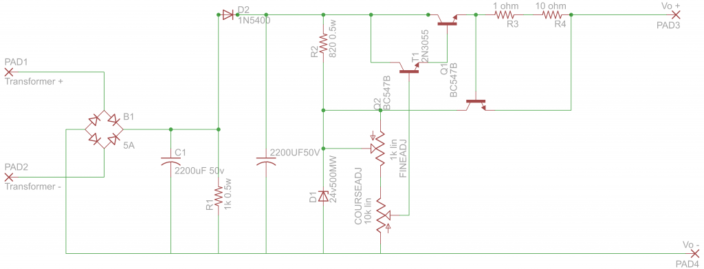

If the 24V zener diode has a tolerance of 5% then its minimum voltage is 22.8V. The Q2 emitter-follower has a maximum Vbe of 1.0V and the T1 emitter-follower transistor has a maximum Vbe of 1.5V so at 3A the minimum output voltage is only 20.3V before R3 and R4, not 25V. R3 + R4 should be a single 0.22 ohms resistor that will reduce the output voltage to about 19.6V.
Without a load the minimum output voltage will be about 21.7V, not 25V so the output voltage drops (21.7V - 19.6V =) 2.1V so the voltage regulation of your circuit is horrible.
If you make a little error amplifier with a couple of transistors with a voltage gain of 150 times then when the output current is changed from 0A to 3A the output voltage will change only (2.1V/150=) 0.014V so the voltage regulation will be very good.

1) If a 27V/5% zener diode is used then its minimum voltage is 25.7V. The maximum voltage loss of the emitter-follower transistors is 1.1V with no load and is about 2.5V with a 3A load so the minimum output voltage will be 23.2V to 24.6V and the voltage regulation is horrible.
2) Q1 and the 0.22 ohm resistor limit the maximum current to 3A. If they are removed and the output of your power supply circuit is shorted or overloaded then something will get VERY HOT and might catch on fire.
Without having an error amplifier and without negative feedback then why do you think a load will make a small change or no change to the output voltage??

An ordinary common-emitter transistor is an amplifier. Google has hundreds of voltage regulator circuits online like this one:
