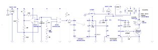

I got some really great advice here on building my budget motor controller. It worked , although not perfectly with old, obsolete parts. So it became time to put everything nicely on a board with components you could actually find and I'm back to about 90% working again. On my scope I get a "nice" square wave (4.2vdc) at the opto output / gate driver input with full duty cycle control. At the gate drive output .... not so much. Do I understand correctly that its difficult to get an output on my scope (due to going - neg or to fast or something)?? Surprisingly I get 100+ vdc testing a hand drill or light bulb at the mosfet. But I get no duty cycle control. Everything I tried gets full power. Maybe someone can take a look and tell me where I went wrong again. I believe I have everything correct to this drawing with updated components.

You appear to have an extra 0.1uF cap between VCC / VS power and OUT on the gate driver?
That will be causing problems, taking a lot of the gate drive current.
Not to mention another random 0.1uF between the two power pins? - but at least theat will have no detrimental effect :D
I presume the spurious one connected to OUT should be a decoupler, going to Gnd?.
OK, I see what you mean about vcc to vcc. It appeared to me they went that way. I couldn't figure out what that would do. Now I know . Thanks. Also I need to get rid of the vcc to out ? That was from the 1st build. Man... I messed up.
Just a nit:
Don't draw schematics with a wire going across half the page to a ground symbol, as that makes the schematic hard to read.
Just put the ground symbol close to component being grounded.
Ground symbols can be put anywhere, they don't have to all be at the bottom of the page.
