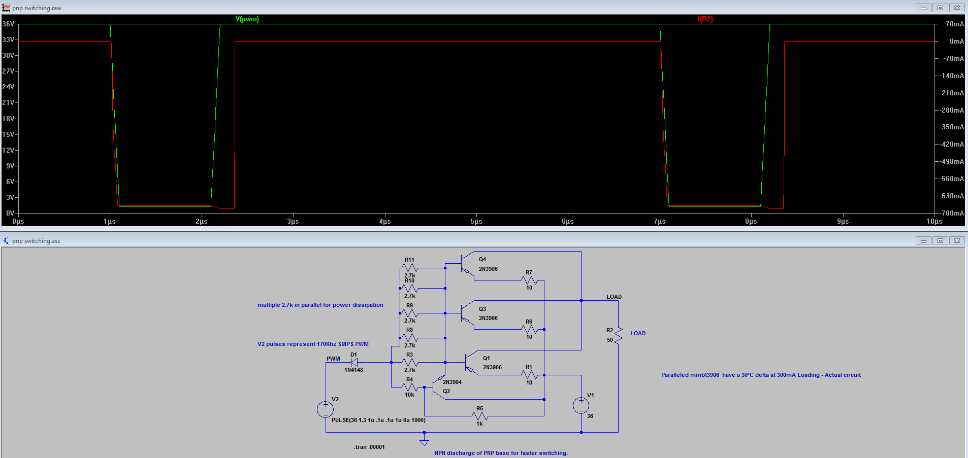

Just for completion. I got the paralleled mmbt3906s to work fine with only a 30°C heating by implementing an NPN to discharge the PNP bases quickly and prevent active mode heating. So the circuit is technically a success and can be implemented. However, I'll probably stick with the NCP3063 solution as it's simpler and certainly less cumbersome albeit it adds to the BOM.
Here's the simulation schematic and graph showing only a fraction of a uS delay in switching. The actual circuit also behaved the same.
Reconsider the Complementary Darlington or "Quasi-PNP-Darlington"
As you know
for the same cost NPN are better
NPN always outperform PNP for lower Rce(sat) and higher Ic(max) for same size or price.
Take MMBT2222A-TP.. same price ($0.023) yet Ic = 600mA vs 200mA for MMBT3906,
or http://www.digikey.com/product-detail/en/MMBT2222A/MMBT2222AFSTR-ND/458866 Fairchild's MMBT2222A ($0.03) Ic= 1000 mA
or http://www.digikey.com/product-detail/en/BC817-25-TP/BC817-25-TPMSTR-ND/1959411 ( $0.032) Ic= 800mA
or http://www.digikey.com/product-detail/en/BCW66GLT3G/BCW66GLT3G-ND/1792162 ($0.023) Ic= 800mA
No need to change your design.
But you ought to learn some lessons.
Which reminds me , P-ch MOSFETs. One part replaces all of that PNP stuff.
e.g. same package CH 40V 3.4A SOT23 ($0.09) 80 mOhm @ 4.2A, 10V
It's useful but I didn't attempt it as 2n2222 is not used in the design only 2n3904s so the BOM issue only justifies the 2n3906.
EDIT: The concept is valid and I could replace all of the 2n3904 with the 2n2222 as the costs are very similar. So your suggestion is valid and I'll keep it in mind for future needs.
One area I was looking at is a capacitive base drive rather than ganged resistors to conserve on heat generation in the base resistors. While certain cap values in the 1 nF region for the 170Khz Freq worked well. A single cap. value couldn't cover the entire range of loads without either causing under saturation or over saturation and missed pulses.
