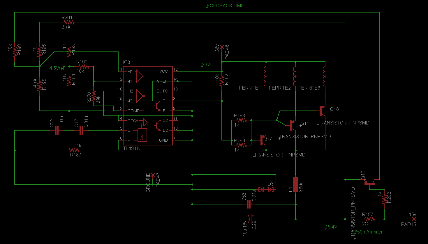

As I only need about 300mA, perhaps a TL494 driving 3 paralleled mmbt3906 PNPs (SOT-23) with 0.35 DCR ohm current leveling ferrite beads on their emitters might do the job. (no parts unique)
The 3906s should drop around 0.4V Vce @100mA and dissipate around 40mW average.
I'd have to add an inductor though. But losing 8W of heat should be worth it. I can clock the Tl494 around 150Khz.

PNP needs 60mA drive to saturate 600mA out peak worst case for 300mA average, not more PNP, thus quasi PNP pair is more efficient if you have no Mosfets
shown on the right..
The TL494 NPN driver transistors can supply 200mA of PNP base current.
I am driving 3 parallel mmbt3906 via 2.7K base resistors from the TL494 NPN, common emitter. The Vcc is 36 with a 1.3Vce from the NPN driver, so PNP base drive: (36-1.3-1 [Vbe])/2700 =12.5mA, which is good for 125mA per transistor or 375mA net. There is a 0.35 Ω DCR ferrite in series with each PNP emitter for load balancing. Sat. Vce on the PNPs should be about 0.5V max giving 65mW dissipation per PNP.
There is a 2 ohm current sense (hi side) with a PNP current limiting foldback at around 0.7V drop or 350mA.

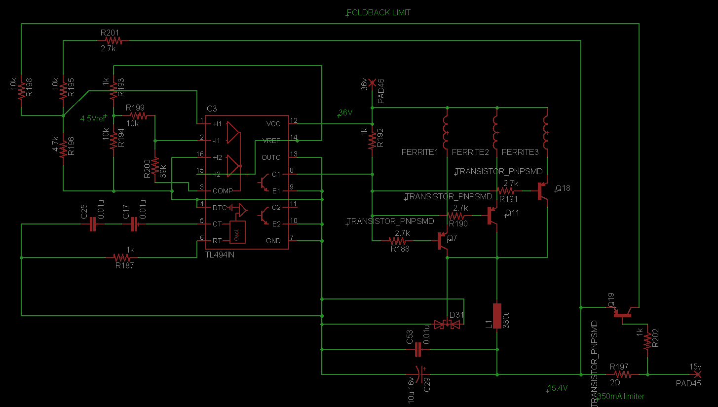

Here is a pic of the schema so far....PCB area is about 1.5 sq in overall using a DIP TL494 and this inductor:

3 PNP's dont help as I said before. THey behave as one unless overheating.
Change R192 to 10k~20K and R188 to 330 Ohm and then drop 2 transistors.
Thats a little better. the 3 transistor have more base drive. The TL494 uses 70 of 250mA max and three 2904s use up to 350mA of 600mA max for an effective gain of 5 max and effective net Rce of 2/3Ω in addition to DCR(L)=0.35Ω for a total of 1Ω where the feedback lowers the Zout to improve load regulation error, but then the current sense R adds 2Ω to degrade it.
1) Can you redirect the feedback from output , instead of before Isense drop of 0~0.7V?
2) Will there be a capacitive load that may false trip foldback?
3) Your clock RC is floating and should be grounded.
4) If you wanted faster startup clock, you would use 1nF to gnd and 1nF to Vref so it reaches Vref/2 on powerup and starts clocking immediately.

1) I could, but it's there to drop the voltage (0.7 x .35 = 1/4W) to the LM317 when under full load to reduce linear reg dissipation. I am limited by BOM resistor selection & space for setting the voltage precisely.
2) No, only a 10uF cap after the LM317. Do u suggets a cap on the foldback Tr base to add stability?
3) It is grounded via the ground pad47
4) Ok
2) Cap on foldback must consider latency , false trigger margin , normal operating margin and Rja thermal resistance, max Tj rise as well as Operator intervention on latchup foldback. DO you want an alert signal or a timer to reset the foldback? These are all your choices. If your only load is the LM317, then it may be overkill.
So far looks ok,, but real world tests determine the reliability. LM317 are pretty old school with a big drop but work.

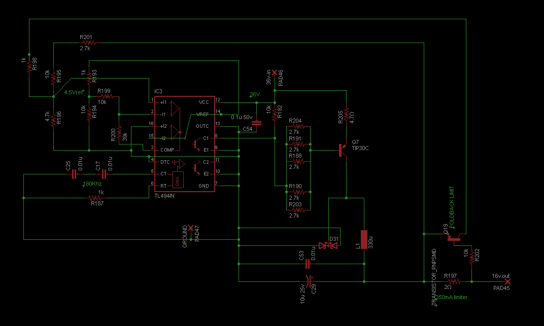

(EDIT: note post #23 solved this heating issue!) Ok, I had to use a TIP30C as the switcher. Ganging the 3906s' worked but the little buggers overheat under full load, switching losses I suppose @ 180Khz. Paralleling more was too cumbersome.
Foldback seems ok without a cap.
Added a 4.7 Ω, 2W, R.emitter to limit startup transient spikes. 3906s died instantly without it. Didn't test the TIP30C without it since circuit works fine with it. A 300mA load uses 1/6 duty cycle. Had to parallel 5, 2.7k 0805 units to handle the thermals for the base drive. Estimate the switching saturates at 800mA peak @ a 15x hfe minimum per the spec. sheet. At 300mA load 15.3V hits the LM317, 16.2V with a 16mA 1K load.

Here's the final schematic.
Now you understand why parallel tiny BJT's wont work.
Since GP transistors are 10:1 for current and R ratios , you have it almost right.
Since a Darlington TIP is two the ratio is 100:1 or 470 Ohms max for Rb.
For less loss, reduce Re and Rb but keep same ratio.
What you had before was like 5 weedwackers trying to power a motorboat.

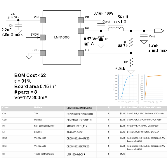

OK now compare that with this .
