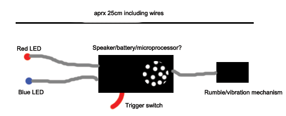

    Hi Guys, I’m looking for some direction on a simple circuit design. Preferably I’d like an electronic prototype producer to do this for me however old google wants to point me to high end electrical engineering companies that are far too expensive for my simple project design. And so i've come to the experts for advice!
    Its basically a trigger switch attached to > a compact speaker > red LED > blue LED > a ‘rumble’ mechanism (such as that in a vibrating game controller) and an internal switch mechanism to control ‘randomness’ (from my point of ignorance I think this would be a microprocessor?) it should cause one of two actions to occur at random when the trigger is pulled, preferably at a ratio of 5:6 where one outcome occurs slightly more often then the other.
    The idea is, when the trigger switch is pulled it either produces a 1 sec sound clip A with a flash of the red LED and a short sharp rumble/vibration OR a 1 sec sound clip B with a flash of the blue LED and no rumble/vibration.
    Do you know if a microprocessor is the right mechanism to use here and/or can anyone recommend a prototype builder who could wire this up for me? I’d be happy to DIY it if it was simple enough to acquire all the parts but am not sure if I've approached this correctly, assuming microprocessor is the way to go.
    Any help or direction would be greatly appreciated!
    Please see how I imagine it to look as a finished item (as you can see I have no circuit drawing knowledge :p ) .

    There is more to your idea than simply assembling prebuilt modules - such as the software to make them all work together. An Arduino has many peripheral devices, including an audio player. What is your programming experience.

    A microcontroller could do what you want. Think of a microprocessor as a device that makes other things work at set times and duration. E.g, when SW1 is operated make sound2 for 5 seconds and send it to speaker1 and flash LEDs 1-5 alternately for 6 seconds. It's not a magic box, just a very fast one.
    At this stage asking for a circuit is way too vague. The pcb is relatively easy, the functionality (sounds, lights etc.) not so easy. Someone could design and build one but it probably wouldn't be what you want, so what then, build another?
    This may make perfect sense to you, but to me it means nothing. What sort of random action, why do you want a 5:6 ratio. In short what the hell are you trying to do? As I said before a Microprocessor isn't a magic box.
    It might be worth your while to do some research into what you actually want. How is the trigger operated, and why? What type of switch do you want? what sort of noise?
    Where is the user going to be relative to the LEDs. A small dimly lit LED won't IMO do much to influence behaviour. A flashing sequence of colours might attract my attention more.
    What power source will be used? What sort of quality do you want from the speaker?
    You don't need to pysically do everything to start with, e.g. Google 4cm speaker reviews (or similar) videos then you can hear the quality or otherwise of 4cm speakers. Let's say you now want a 10cm speaker because of its quality, only problem is it will be too big and a new problem, it needs too much power i.e. a big battery. Time to compromise.
    Once you've figured out what you think you need, then start DIY. Arduino is very popular because it's cheap and there are lots of ready made modules (shields) and it's fairly easy to program. The Shields are designed for people who just want to make it go without the hassle of building every module and minimal programming.

    Makes sense to me, but I grew up on a university campus and later built research equipment for six years. The big complicating factor is the audio. If two electronic tones, one pleasant and one not, were ok, the the whole thing could be done in hardware (no programming. It would take a few chips and their supporting parts, but still - no programming. But, since you have no hardware experience either, you still would be dependent on the kindness of strangers.
    I don't think making the device wobble will be unpleasant enough to add to the conditioning. A small electrical shock would be, and that is something very easy to control safely, but the human subjects review would be tough.

    I'd definitely use a micro, choosing which one is like picking an ice cream flavor.
    For sound, I like the Winbond ISD series chips (Digi-Key).
    For 2 sound clips, just toggle the highest address bit.
    I've built several museum exhibits with them.
    Writing a "random" number generator is easy, good ones aren't.
    Read a free running counter/timer and "bin" the range into the number of outcomes and their ratios.
    In your case, 11 equal size bins, if 8 bit value, each ~= 23 values wide.
