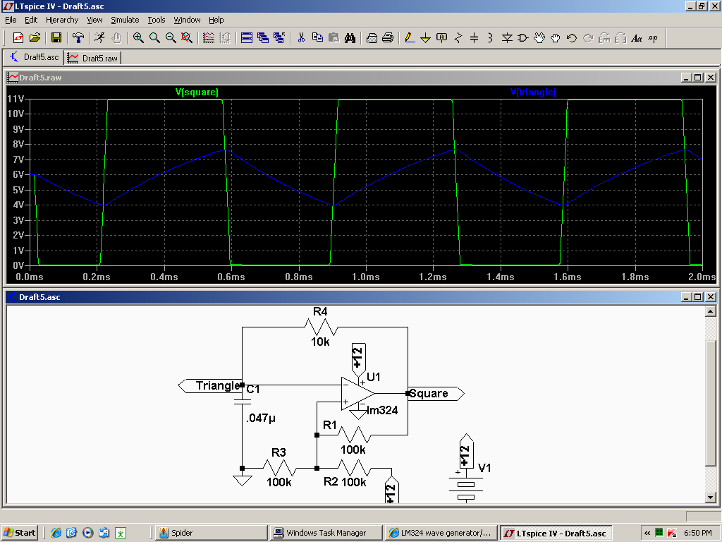

Osc.
I'm not sure if this is what you want, but it will produce a square wave and triangle wave. Change the frequency by changing C1 or R4. AC couple it with a large capacitor to your audio amplifier.

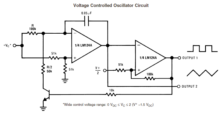

The datasheets for the LM324 quad opamp and LM358 dual opamp show a VCO circuit that goes from a very low frequency growl to a fairly high audio pitch.
An MC34074 quad opamp (or MC34072 dual opamp) can be used instead in this circuit for a much higher frequency.

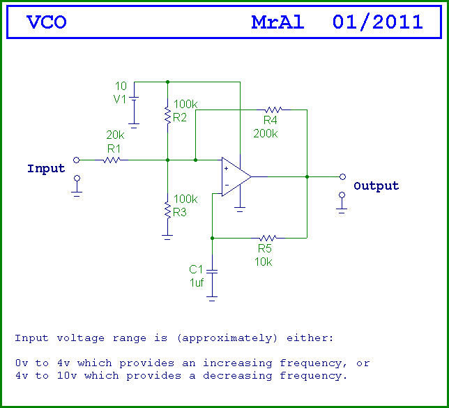

Hello,
You can create a simple VCO from a single section of LM324 or LM339 and a capacitor and a few resistors (see diagram).
Note if you use an LM339 you will also need an appropriate pull up resistor.
Also note if the power supply is other than 10v then the input ranges will be different than shown in the diagram.
You can play around with the values to change the frequency range and other characteristics.
Added note:
A more accurate value for the input voltage where we change from increasing frequency (with Vin) to decreasing frequency is 4.3 volts.
Thus, the frequency increases from 0v to 4.3v and decreases from 4.3v to 10v.
what does that symbol mean on the VCO below R/2? its a straight line with an arrow at the bottom connecting to ground?
In the VCO circuit I posted from the datasheet of the LM324 and LM358 the "thing" is called an NPN transistor. The arrow is its emitter. Use a 2N3904.
