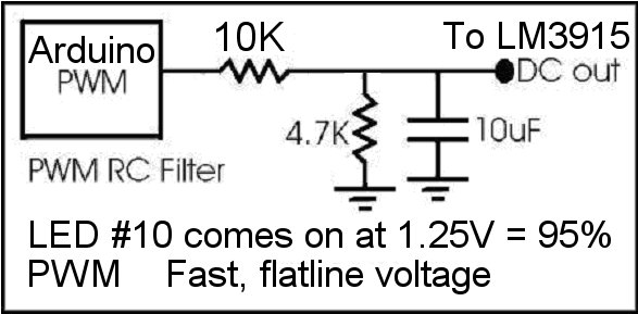

The LM3915 bar / dot display driver wants an analog input up to 1.25 volts where the tenth LED comes on.
Arduino analog output is actually PWM at 5 volts, using a 5 volt supply.
This gets a smooth voltage between 0 v. & 1.25 volts.
If it matters, I am using a 1K resistor between the pins 6&7 pair and ground on the LM3915.
DAC would be another option but perhaps overkill :D

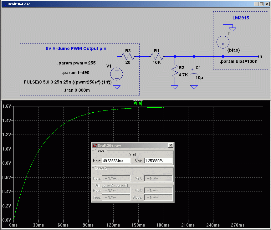

A more detailed analysis:
I account for the Atmega328's Digital Port Pin output impedance and the LM3915's input bias current. If the PWM frequency is 490Hz, here is the startup (full scale pwm=255) settling time and final value (a bit too high if pwm=255). A pwm value = 202 gets above V(in)=1.25V:

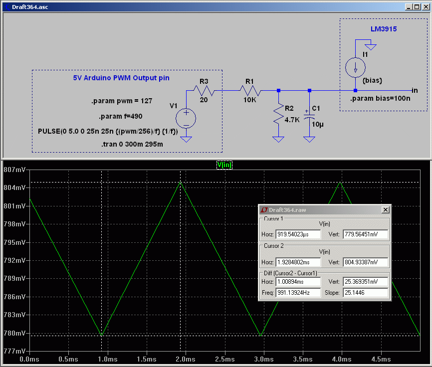

Here is the ripple after settling with pwm=127 (half scale, worst case):
Thanks MikeMI
25mV ripple is pretty good. Does the LM3915 mind getting 1.6 volt input?
"Input Signal Overvoltage ±35V. Pin 5 input current must be limited to ±3 mA. The addition of a 39k resistor in series with pin 5 allows ±100V signals without damage."
Am I okay there?
I am using a MSGEQ7 connected to the analog 0 input of a Arduino Uno. I am sending the 5 lower frequency volume signals with PWM to 5 LM3915 chips which drive 5 columns of bright white 10 LED bar graph displays. It looks great with fast flashes to the beat and notes. The 50 LEDs are mounted in holes from the back of a 8" wide X 10" high sheet of Plexiglas. I intend to add colors when I find tinted plexi, plastic or cellophane. It will fit into a clear box type picture frame.
Measure the ripple with pwm=128?
Write a test program that slowly changes the pwm value from 0 to 255 in steps of 1 { for(pwm=0;pwm<256;pwm++}, dwelling on each value about 1sec {millis(1000) so it takes 256 sec to cycle from zero back to zero}. Watch the LEDs. How long do two adjacent LEDs overlap before you get only one on?
Filter ripple test.
