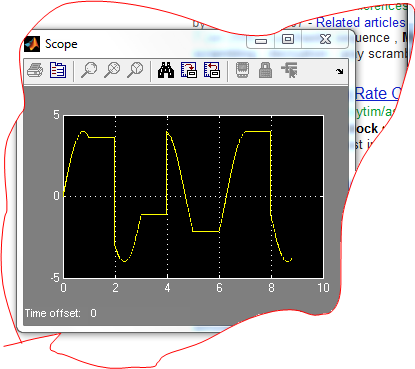

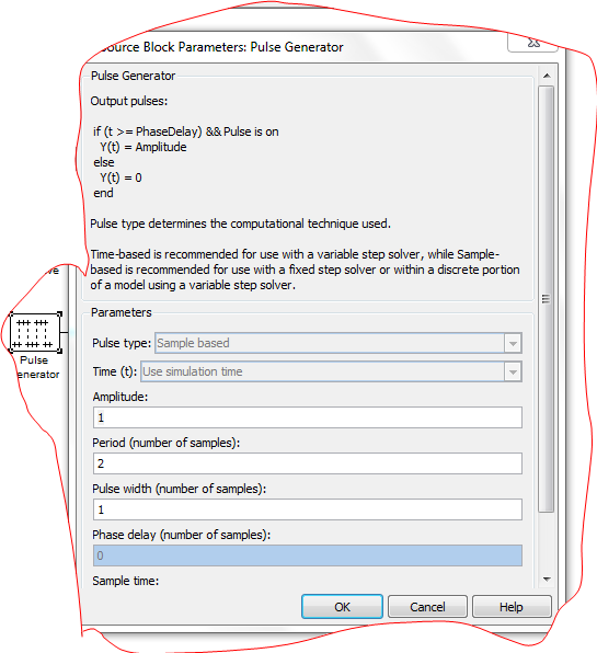

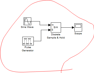

this is sampling circuit (using matlab)
but it give uncorrect result i want output to be (pam-flattop)

If you want to generate flat-top pulses that are a sample of the AC waveform at an instant in time then you need to make the S signal very short compared to the period of the AC signal.
