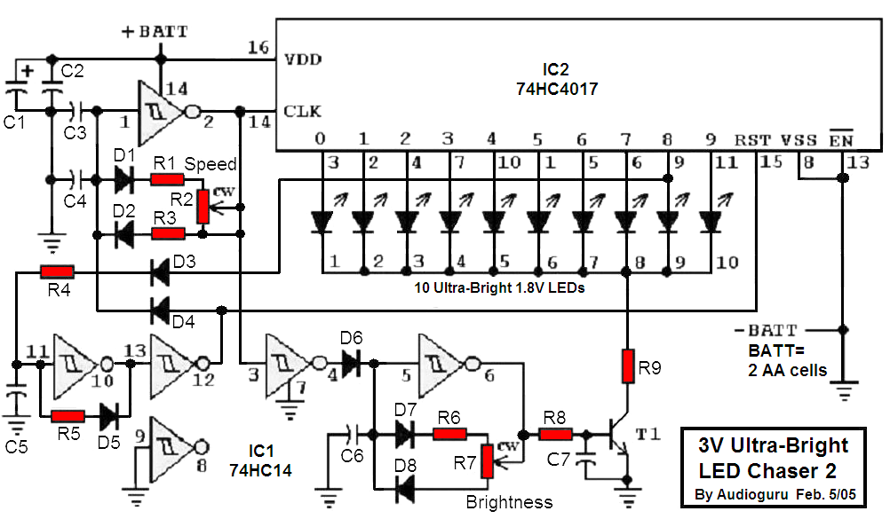

I have some red blinkers that use two alkaline AA cells that last for 3 months. I do not use a current-hungry 555 instead I use a Cmos gate IC as the oscillator and a Cmos 74HC4017 to drive 10 LEDs, one at a time. Another design uses four AA alkaline cells that last for 3 months and has higher voltage blue and green LEDs.
The key to low current is to blink each LED for only 30ms then a pause before the next LED blinks, and after the LEDs go around and around in a circle a few times there is a couple of seconds pause with no current used before it starts again.
Here is my circuit:

As AG said, off-time = battery life. With a simple 555 circuit and two LEDs, one or the other is on all of the time. So the battery life is less than just having one LED on constantly because the 555 circuit uses some current that doesn't go through either LED. There are several ways around this. One is to look into joule thief circuits. These are extremely efficient LED blinkers designed to use the last ounce of charge in an otherwise useless battery. Another is to have the timing capacitor charge dump into the LED so you get double-duty out of those electrons.

In my LED projects where the battery lasts for 3 months, the LEDs blink and are OFF most of the time. Simply using a multivibrator so that there is always one LED lighted and the continuous current in the ordinary 555 will kill the battery in a short time.
Here is my circuit:

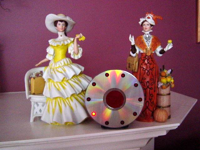

Nice use for a discarded CD.

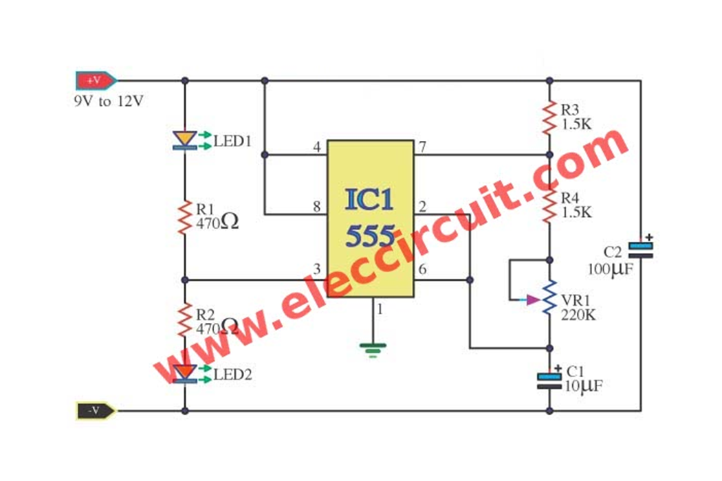

Thx to Reloadron, I found a "Blinky" schematic I like. Ned I PM'd you, hopefully you received it. This is the schematic I plan to use. I am using a 9 VDC wall wort so battery consumption won't be a problem. This dwg. allows the flash rate to be varried from slow to steady state. The LEDs flash symetrically too. I'm just not sure if the 100uf cap is needed, not sure what it does. Tom

The 100uF is a supply bypass capacitor but some people say it decouples the power supply. It is important for most circuits even if the power supply has one because the wires from the power supply have series inductance that causes the voltage at the circuit to jump up and down with loading. The old ordinary 555 causes a 400mA power supply current spike each time its output switches and the capacitor supplies this current. The datasheet of an LM555 talks about this capacitor.
