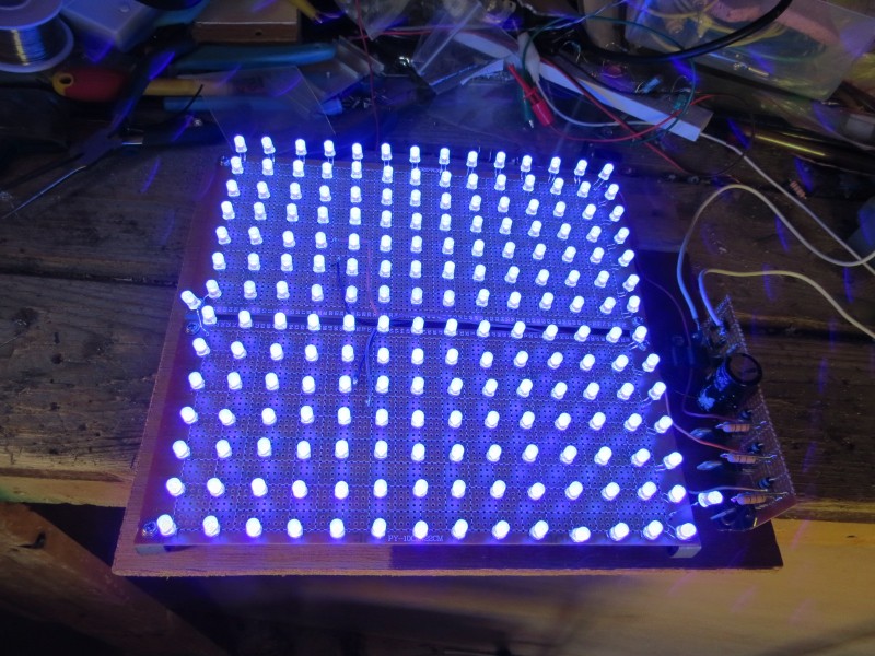

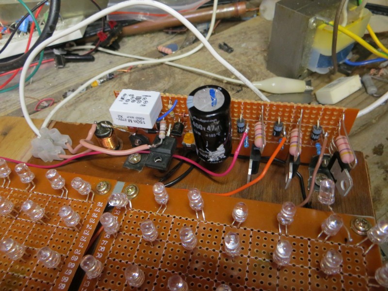

Lots of UV - makes your eyes go funny! The couple of odd placed LED's are due to the geometry of the perf boards, though it should work perfectly well without them. I wanted to check voltages before messing with the numbers. Only the resistors get hot, nothing else.
Exposed a test piece of dry film very effectively. Waiting for a timer to arrive in the post so I can do calibrated exposures.
I made a (not very good) deep box that the array sits at the bottom of it. Haven't had time to try making any boards with it yet.

I second that too. Very well laid out perf-board construction.

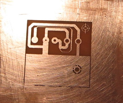

Just made a "do nothing" test board with it. After about 10 attempts to get the process right, I got:
thinnest track: 5mil
smallest gap between tracks: 5mil
smallest hole in pad: 10mil (I did a 5 mil one but it it didn't etch. I think I didn't clean the unexposed film in the sodium carbonate long enough)
finest detail: target shaped pad with 3mil detail. One of the arms has gone
fine gap between large areas: I did a ground plane, then the board outline, then spare copper outside the outline. So the gap is 5mil. It got partly filled on one side but that might have been a sharpie accident where I covered the spare copper around the test area.
Mounted the board in a cutout in some cardboard before putting it through the laminator. All previous attempts were using a clothes iron, which had worked well when I made my first board to test the film a while ago. Exposed on top of my UV box for 23 elephants (since I don't have a timer yet). The film is a bit wrinkly so the iron didn't work so well this time.
Only using a single transparency - I know a lot of people recommend a double layer. Maybe I'll need it for bigger boards
