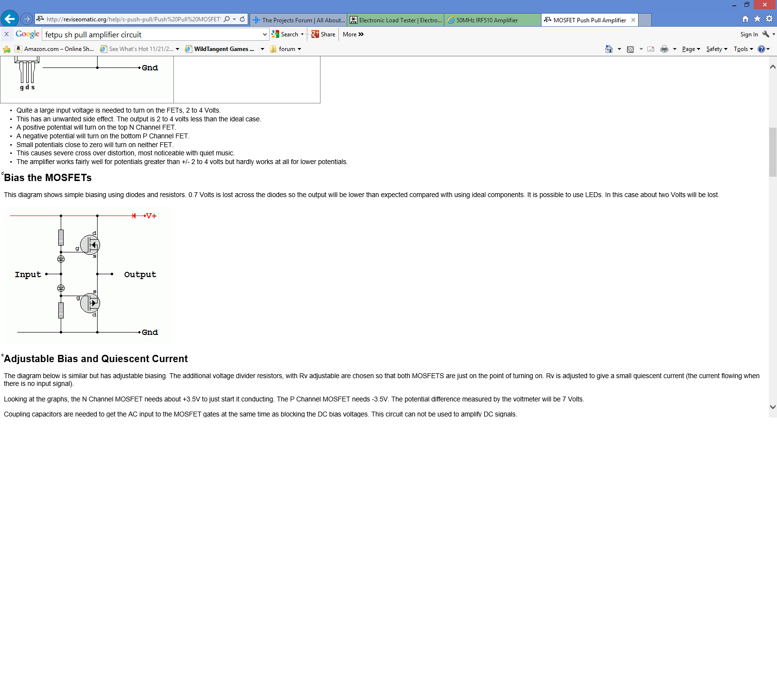

I don't see a schematic, but I suspect it is a push pull arrangement like this:
Here is a read on the way to do it. See the part under electronic load.

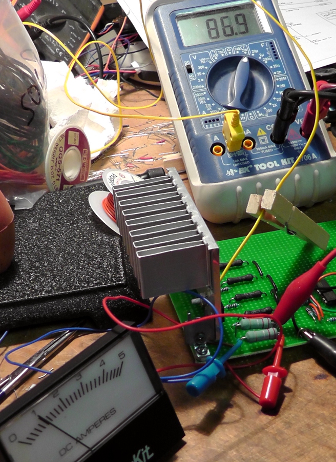

Today I built the circuit and tested it - one quarter of it. I wanted to test out the MOSFET with the feedback servo and see if it would regulate the load from about 0 to 1.25 Amps. All appeared to work OK, so I will now expand it to all four MOSFETs and that should get me up to 5 amps.

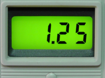

Here is a picture of the test. On the bottom the current meter shows 1A. It was actually 1.25 amp, and I have to zero the meter and tweak the shunt resistance to get that to read correctly. On top is the DMM set to show degrees F. The thermocouple is pressing against the heatsink tab. Here with 1.25 A flowing through it, it stayed below 90 F, I pushed it up to 2A, and it was just a bit over 100 - and that was without any fan blowing on it. With the AC meter I didn't read any AC on the MOSFET's source or gate. I'll scope it when I get the other three wired up.
As far as current control, the pot seemed to give me a good and linear range from 0 to 1.25A, but it wasn't through the full range of control. Upon closer inspection I found my "oops". The 0.25 ohm current sense resistor was mistakenly 0.1 ohms, so by not sensing the full actual current on the MOSFET, the op amp would "go to the rail" trying to turn on the MOSFET more, but it wasn't to be. That would happen at about 1/2 travel of the pot, and anything higher would not get me any more load current.

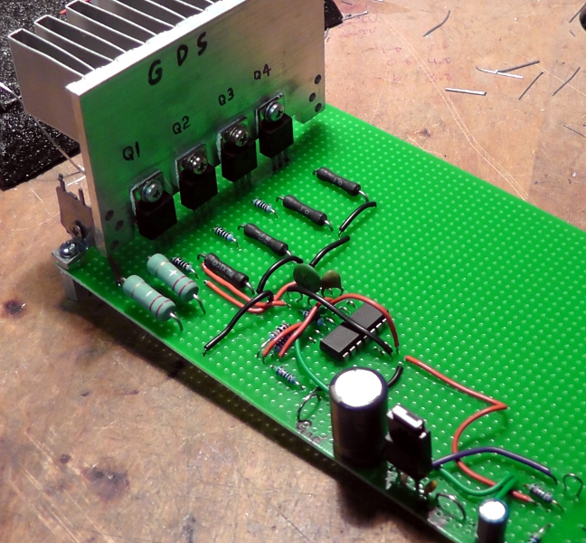

The 2nd picture shows the circuit built but not wired-up for testing, the 15V supply is on the lower edge of the board.

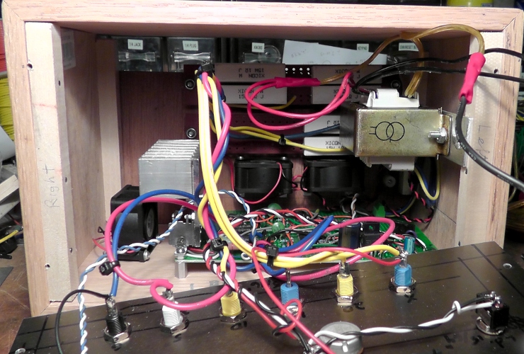

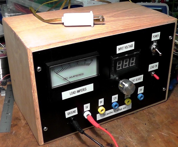

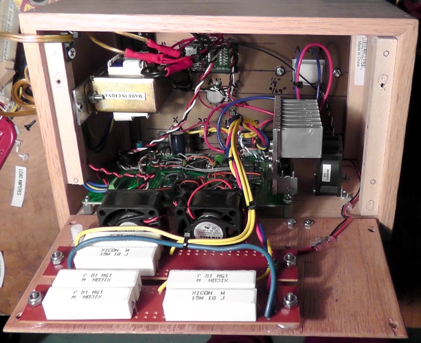

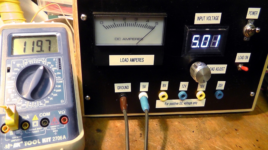

Here are a few pix of the finished product, assembled in a oak box:
First is the "Formal Portrait, then the front panel opened up, then the back door opened up. The FET loads are on the left of the circuit board mounted to the floor, with a small fan blowing right on the back of them. The two other fans are on the rear panel and blowing up across the load resistors.
Here is the back door opened up showing a better view of the load resistors and fans.

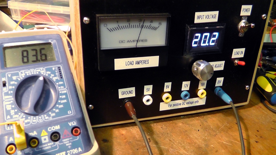

The next two show that at 5 volts and 5 amps, the temp of the heatsink holding the four MOSFETs stabilized at 119 degrees F.
I couldn't hit 120 degrees until I pushed it beyond 5 amps.
The last picture shows 3Amps at 20 volts, and how the temp remains in the 80 degree range because the resistors are taking a lot of the load.
