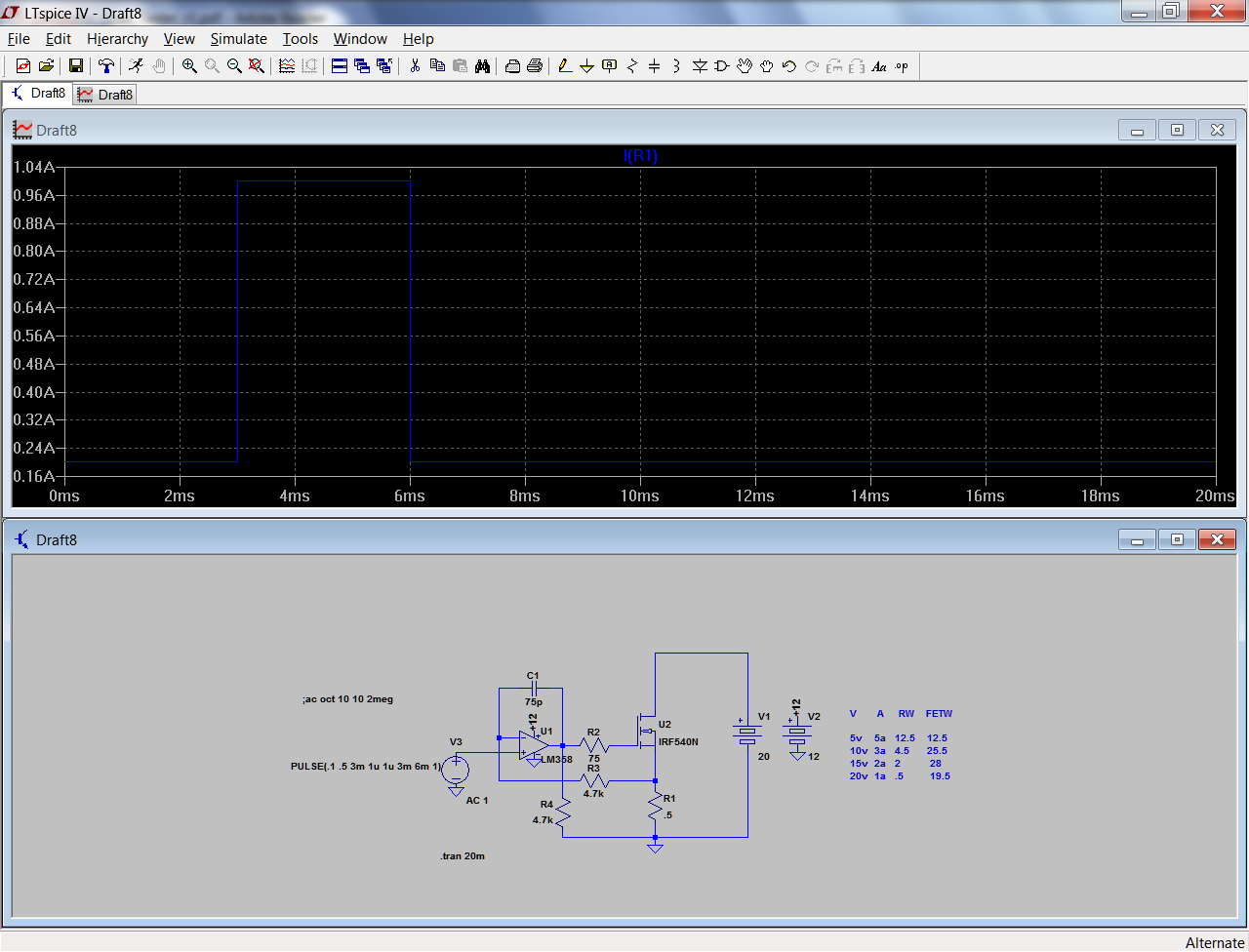

Do you have any other FETs? We could make it a lot simpler if you have one with a lower Rds on.
We can worry about compensation later, but here is some "stuff" about the problem of driving FETs with op amps. Fig. 7 is what we are after.
Maybe you have an LM358 or 324 in your parts bin?
Take a look at this. It burns most of the power in the FET. But since you have a big heat sink and a fan, why not.
The op amp and FET are common (cheap) ones. With the larger voltage drop across the source resistor the offset of the op amp is less of an error.
I used 12 volts for the op amp thinking you might have a 12 volt fan out of an old PC or something.

The load1.png picture brings up a lot of questions. Why the 75p for AC feedback? Do I want a series resistor on the gate or a parallel resistor to ground? Is that the "source resistor" you refer to and is op-amp offset going to be an issue? I thought the negative feedback would negate all that "offset crap" in this case. Does a series resistor really do much when it is a high-impedance input? I imagined that the parallel resistor will pull more current from the output, making it a lower Z circuit and therefore making any stray capacitance more insignificant.
You need the gate resistor to isolate the op amp from the high capacitance of the fet. The 75 pf optimizes the frequency response to make sure it does not oscillate.
You could add 5 ohms for the 10 volt and above and that would get the power down in the FET. Or you can just lower the sense resistor and a big heat sink with fan.
