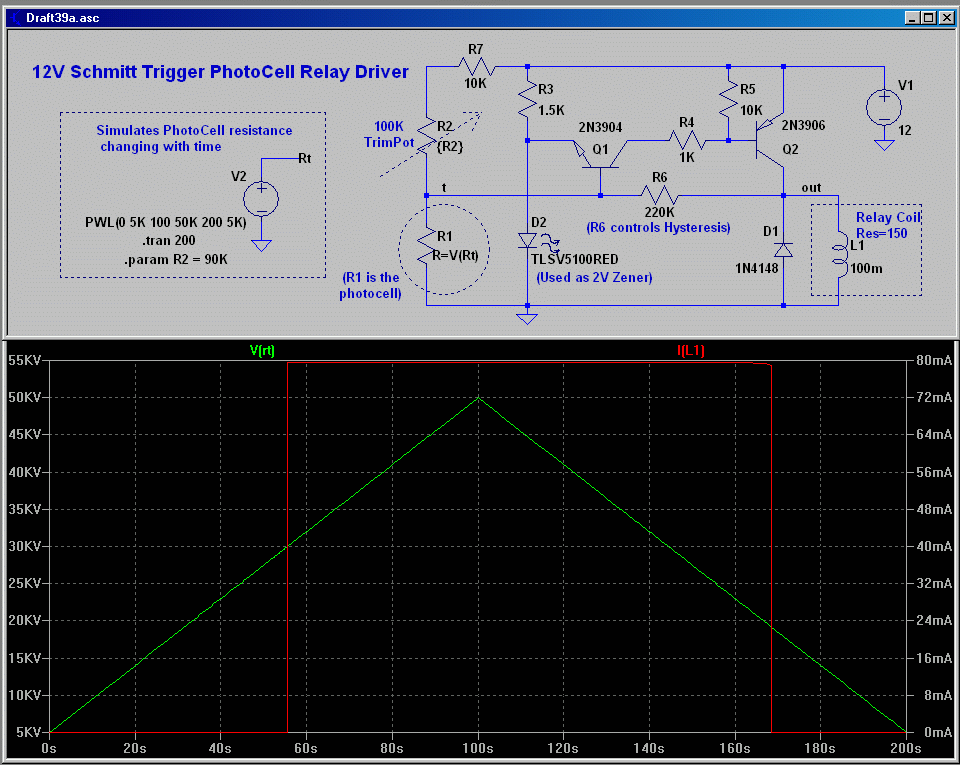

I received a PM asking for a 12V version of the circuit I posted back in #18 of this thread. Here it is.
The resistance of the simulated LDR (R2) is plotted as the green trace. The resistance of R2 in kΩ is proportional the voltage in kV. The red trace shows the current through the 12V relay coil. Note that with the setting of the trimpot shown (R2=90kΩ), the relay picks up as the LDR resistance increases through ~30kΩ, and drops as the LDR resistance decreases through ~18kΩ. Changing R2 effects the primarily the LDR resistance when the relay trips. R6 effects the amount of hysteresis.

Hi MikeMI,
Quality test of your design has been done just now! :) Wow it's so impressive and I never expected that we can make such non-linear dark detector just using two pieces of general purposes transistor! Before I've seen various comparator based circuits to get non-linear (escaped from relay chattering problem) output. So I was worrying to use any rare (here) comparator ICs! It's mindblowing idea! And not only from 12V, it's working with just 4V too. And at 4V, I used a LED as a load and its ON OFF is looks like digital ON and OFF! I know 2V LED (D2) is doing magic in the circuit, by setting a threshold (Vref) voltage and like a comparator.
