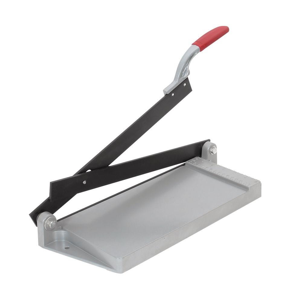

Shears for cutting floor tile like the one pictured work great and cost about $50. It's fast and easy to get square cuts, without the dust resulting from sawing.
Someone mentioned that the dust is hard on bearings. It will also damage your lungs! When sawing circuit boards, wear a dust mask.
