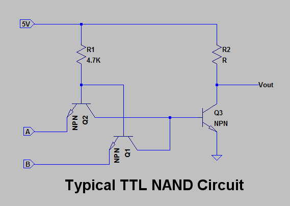

Billy, below is a typical NAND circuit.
If inputs A & B are logic High what will Vout be? What will happen if I try to force Vout to its alternate state? Make R2 1K Ohm. If you would like I'll string a few together but the end result will be the same.
Ok there is more of a voltage drop across Q3 ( output transistor ) when you force V out to an alternate state , because the Transistors collector will have close to 5 volts , 5 volts divided by collectors resistor.
What will have is a VCC to ground short in parallel will Q3 ( output transistor )
The Current is SINKING into Q3 ( output transistor ) in either logic state LOW or HIGH, VCC +5 volts is SINKING into Q3
LOW logic state = +5 VCC sinking into the output transistor Q3
HIGH logic state= + 5 VCC sinking into the output transistor Q3
Hi Billy, if A and B are high then Vout will be a logic Low. Truth table for a NAND gate. So with Q3 turned On it is at Ground for Vout or really close anyway. If I place a High (5 Volts) at Vout I will toast Q3 and that is the end of the gate. That is it and that is why you can't play this game of forcing logic levels. Now in that instance if the Vout was high then yes, I could force it low. The trick is knowing what you have. You can't just run through a circuit arbitrarily forcing highs and lows.
Ok , but that goes back to my question as to why a logic pulsar will work when FORCING a HIGH logic level on a Vout that is Low , why doesn't it Toast Q3 output transistor ?
I wish Ron didn't delete his post showing an open-collector NAND gate circuit because Billy's answer in post #107 shows that Billy knows NOTHING about electronics:
1) The NPN output transistor is turned on. The collector resistor is connected to +5V then the collector is forced to +5V. Then how much current is there in the collector resistor? Why did Billy even talk about the collector resistor?
2) Why does Billy say there is a short parallel to the output transistor when the output transistor and the forcing are in series?
3) Why does Billy say that the output transistor is sinking current when its collector is forced to +5V in either logic state LOW or HIGH when the output transistor is not even turned on when the inputs turn it off?
I was talking about the voltage drop ACROSS the collector resistor , not the voltage drop referenced to ground
How can the forcing be in series? it's a parallel path when your force it to VCC or force it to ground , it's not a series path
When both inputs are HIGH, the output transistors is turned OFF , when both inputs are LOW , the output transistor is Turned ON

One end of the collector resistor is connected to +5V and you are forcing the collector end of the resistor to +5V.
Then how much voltage is dropped ACROSS it?
Again you are COMPLETELY WRONG!
The NPN output transistor is turned on so it is trying to make its collector voltage as low as it can. Then you are forcing its collector to +5V in series.

When you force the voltage at one end of a resistor to be the same voltage that is at its other end then it does not matter if the transistor is on or off.
So the Collector resistor tied to +5 is not a path or branch?
No, because when you force the voltage at one end of a resistor to be the same voltage that is at its other end then you are simply shorting the resistor.
The current path is from the forcing voltage in series through the turned on transistor to ground. The collector resistor has nothing to do with it.

Logic outputs, either TTL or CMOS, are typically of two types. Either totem pole or open collector (open drain for cmos).
Totem pole output have two transistors. An upper transistor from Vcc to the output, and a lower transistor from the output to ground. The upper transistor is ON when the output is HIGH. The lower transistor is ON when the output is LOW. In both cases the opposite transistor is OFF. More than one totem pole outputs should not be paralleled since, if the two outputs were different states, would put an ON upper transistor in series with an ON lower transistor which would cause a short from Vcc to gnd.
Open collector (drain) outputs have only the lower transistor. When the output is LOW the transistor is ON. When the transistor is OFF, the output is open. You need to use a pullup resistor to make the output actually be HIGH. Open collector outputs may be paralleled since there is no conflict with one out being LOW and other outputs being HIGH. The net is lLOW if any of the outputs is LOW, and high only if ALL of the outputs are in the open state, when the pullup resistor makes the net HIGH.
A logic pulser actually does force a net with a LOW output HIGH, and a HIGH output LOW, but does so with a very short pulse (typically a few microseconds) so that the output that it is working against is not damaged.
A logic probe does have a pulse stretcher. This is needed to make a pulse that would be far to short for a human to see long enough to do so. An o'scope doesn't have anything called a pulse stretcher, but can accomplish the same thing by storing a pulse, as well as letting you see the pulse timing and shape.
