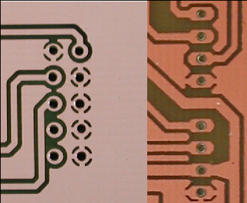

Have you tried what I suggested about using a small center punch/dimple/guide hole -- whatever you want to call it -- or are you just rejecting that suggestion on theory? In the situation where you have a handheld board on a smooth table surface, if you get the drill tip anywhere within the area of a etched hole in the copper plating, it will tend to pull the board and center the hole. The movement is not great, just a few thousandths, but you can both see and feel it. The speed of the drill also can make a difference on that centering effect.
On the other hand, if you have a very rigid set-up, like the board clamped to a CNC milling table, then the effect may be to bend the drill and make a crooked hole. I am assuming that is not the case here.
John
Edit: I don't often photograph my just etched boards -- I wait until I cover my mistakes with solder--, but I found two examples. The holes are #66 (33 mil). None are perfectly centered, but they were OK. Done with drill press, drill-aid.ulp, and just a goose-neck lamp attached to the drill press column to give good lighting. Traces on the left image are 24 mil. The #66 drill is the hole size I use for a typical 0.1" on-center, square-pin header. The redish tone on the right example is due to the photoresist I use that has not yet been removed.
