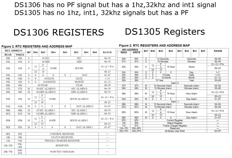

Im fixing my toilet right not but ill write some quick info ...
If you take a look at the datasheet about the registers...
ds-jpg.49381
To get the seconds we need to read register 0x00
To get the minutes we need to read register 0x01
To get the Hours we need to read register 0x02
Lets call these variables bcdSec,bcdMin,bcdHour...
Now to convert them to decimal so we can add or subtract easier we have to do a BCD to DEC conversion.
Using this code:
unsigned char bcd2dec(unsigned char val)
  return (((val>>4)*10)+(val & 0x0F));
we can convert seconds and minutes to decimal since these registers use the upper 4 bits for 1 number and the lower 4bits for another number...
For example if the time is 10:20:40 PM
The bcdSec variable will hold the seconds which is 0x40
This is the same for bcdMin... It will have 0x20
If using the 24 hour mode bcdHour will be 0x10
BUT....
if using the 12 hour mode bcdHour will be 0x70
Basically in 12 Hour mode our code has to check the AM PM bit... and also the 12hr mode bit...
so we have to take care of that
LONG STORY SHORT... Since your using 24 hour mode. You can use the bcd2dec without a type:
