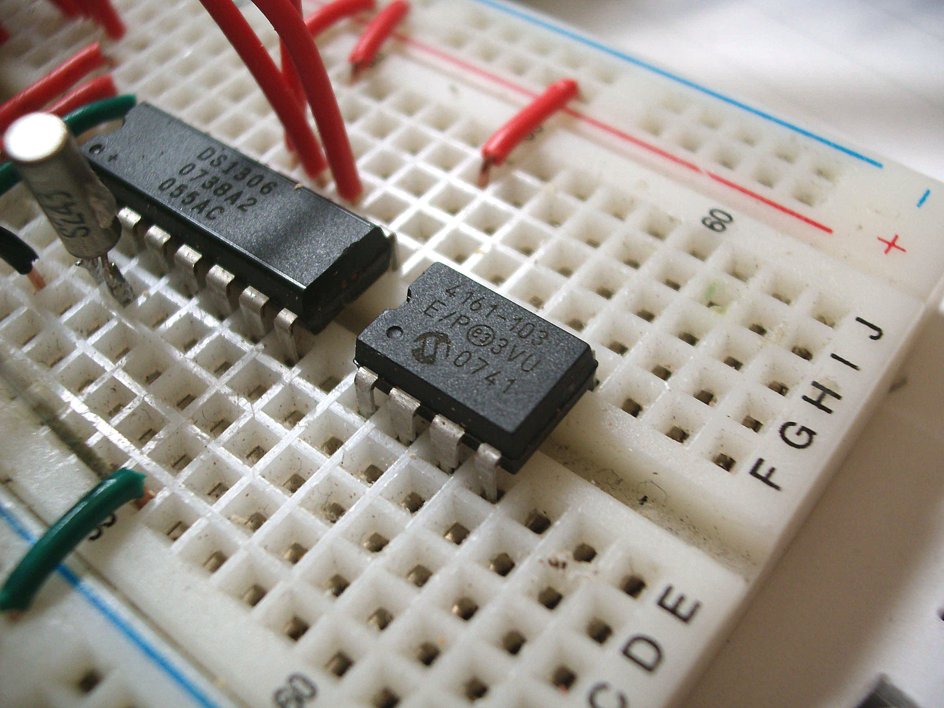

Hello,
Jason, would you please post your last MPLAB package and Proteus simulation of your nice DS1306 RTC project ?
May i have some questions :
If i want to use 24H format instead of 12H , what should i change in BCD function ?
what | 0x40 = 12 Hour Mode do exactly ?
i do not understand it well, what should i modify if i want to go with 24H format ?
    Convert to BCD for the RTC(DS1306)
    bcdHour = uint2bcd(decHour) | 0x40;     //0x40 = 12 Hour Mode
    if(decAMPM >= 1)
        bcdHour = bcdHour | 0x20; //0b00100000
    bcdMin = uint2bcd(decMin);
Best Regards,
I dont have a proteus file sorry :(
The | 0x40 simply sets the bit for 12hr mode... for the RTC
Ok to use this with 24HR mode is hard because you have to edit a lot of code heh...
Remove all the | 0x40... since this tells the RTC that we use 12hr mode...
Now you have to remove all the AM and PM code...
Then you have to find all the code that has to do with the HOUR only and have it also read the 5th bit of RTC ..
From the datasheet:
The DS1306 can be run in either 12-hour or 24-hour mode. Bit 6 of the hours register is defined as the
12- or 24-hour mode select bit. When high, the 12-hour mode is selected. In the 12-hour mode, bit 5 is the
AM/PM bit with logic-high being PM. In the 24-hour mode, bit 5 is the second 10-hour bit (20 to 23
hours).

Thanks, I see better now.
There is also something I don't understand well with SPI and RTC:
When reading the time, we set the read register and then we send 8 times 0x00 to fill in the buffer.
But why send 8 times 0x00, normally sending one time the read register address should get the result, shouldn't it ?
you are right i did not see that in your code.
I found a code somewhere that do the following to fill-in a table with value, what do you think about it ?
I do not understand why it uses dummy read with 0x00 :

This snippet was used with DS1306.
I've some DS1305 at home, do you think it should be compatible with your DS1306 code ?
did some looking around datasheets and yep you can use it...
ds-jpg.49381
Also that code you posted looks more like hes reading the RTC in burst mode ... hes sending 0x00 just for the clock to continue...
It seems to be reading 7 bytes at a time
