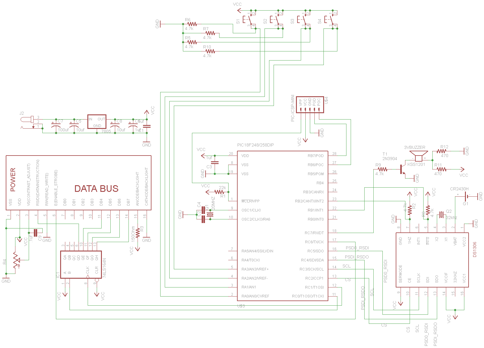

Any thoughts of why this isnt working? It seems to only jump to the "high_isr".
I have the 1hz thing from DS1306 to RB1 and RB2 is the INT0 from DS1306

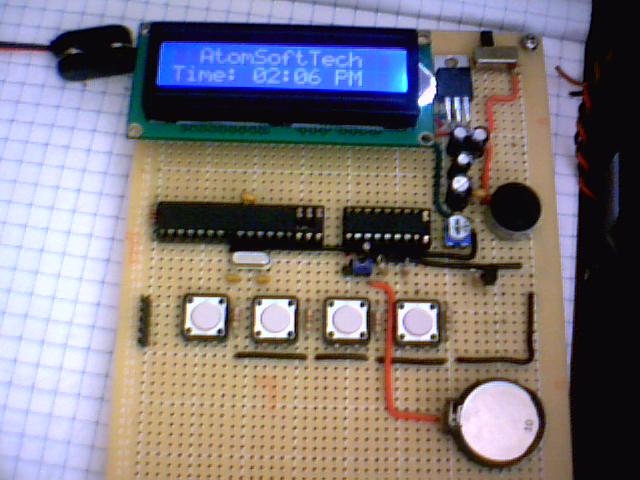

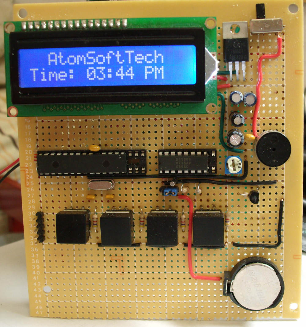

ok this code is all of it except set the date i left the simplest for last lol The interrupt seems to be working now i think i had a bit wrong dont remember.

compete Rev 2 code: (new schematic coming soon!):
 *          AtomSoft Clock Using PIC18F248, DS1306, 74LS164, 3v Buzzer
 * FileName:        main.c
 * Author:          Jason Lopez
 * Processor:       PIC18F248(0)
 * Compiler:        C18
 * Company:         AtomSoftTech
 * Version:         2.0.0
Here is a picture of it in prototype form. Ill post a video soon.
New code with commented updates:(REV:3)

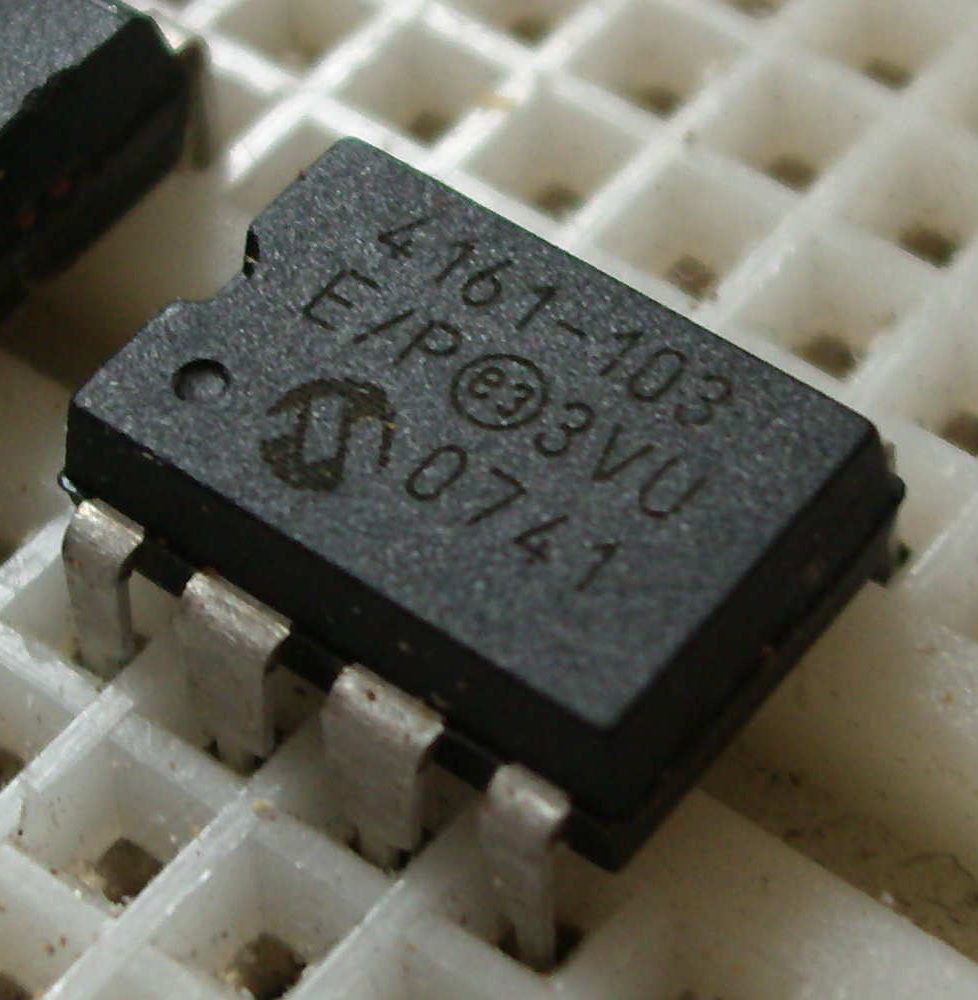

here is a better picture.. my camera came in yay! i took a nice picture of a IC also to test the depth of the picture lol
Excellent! What camera did you get?
What's all the mung in the IC macro photo? :D That's a dirty, dirty breadboard. It looks like you been eating crackers over it. :p
Mine always have cat hair when I zoom in close.
Whats MUNG?
Unidentified icky stuff?
In some circles 'mung' is used as a word meaning foul material covering on a surface, i.e., "you've got some mung in between your teeth" or "you left your mung on my table." Military mechanics loosely use the term to refer to a combination of axle grease, mud, and dead things that were crushed under the equipment, and anything else that is generally left to be sprayed off by the lowest ranking shop worker. This concept has spawned cast-offs, implying that anything that is supremely disgusting can be said to be "mung".
Nice price on the camera. Would make a good "beater" for places I don't want to take my good camera. Decent macro shots.
yeah it said 5cm but that was about 3cm distance. It does awesome nice video also. (mainly of people) Close up video is decent. Ill post something on youtube in a minute
You have inspired me :) Santa brought me a Samsung L200. Up to now I have not taken the time to mess with more then point and shoot. You closeup looked so good I had to give it a try. The auto focus in close is a bit hit and miss. I did not manage to get in as close as yours. Good work :)
Up to now I had left the bit of clingy plastic covering the LCD. It made a nice but foggy protector.

hey some of you know i have been working on a clock using a DS1306 and i wanted to post this for anyone who wants to see it. at the moment you can only set the time. Its a huge file.
You can study about BCD conversions, SPI, Shift Registers(74LS165 & 74LS164). I say you can study mainly because it all works so far. And if it works then maybe it can help some people.
Im in the process of adding code to Set the Date including Day, month, year, actual day... take a look.
I rewrote my old code. This should be a nice read for some.
