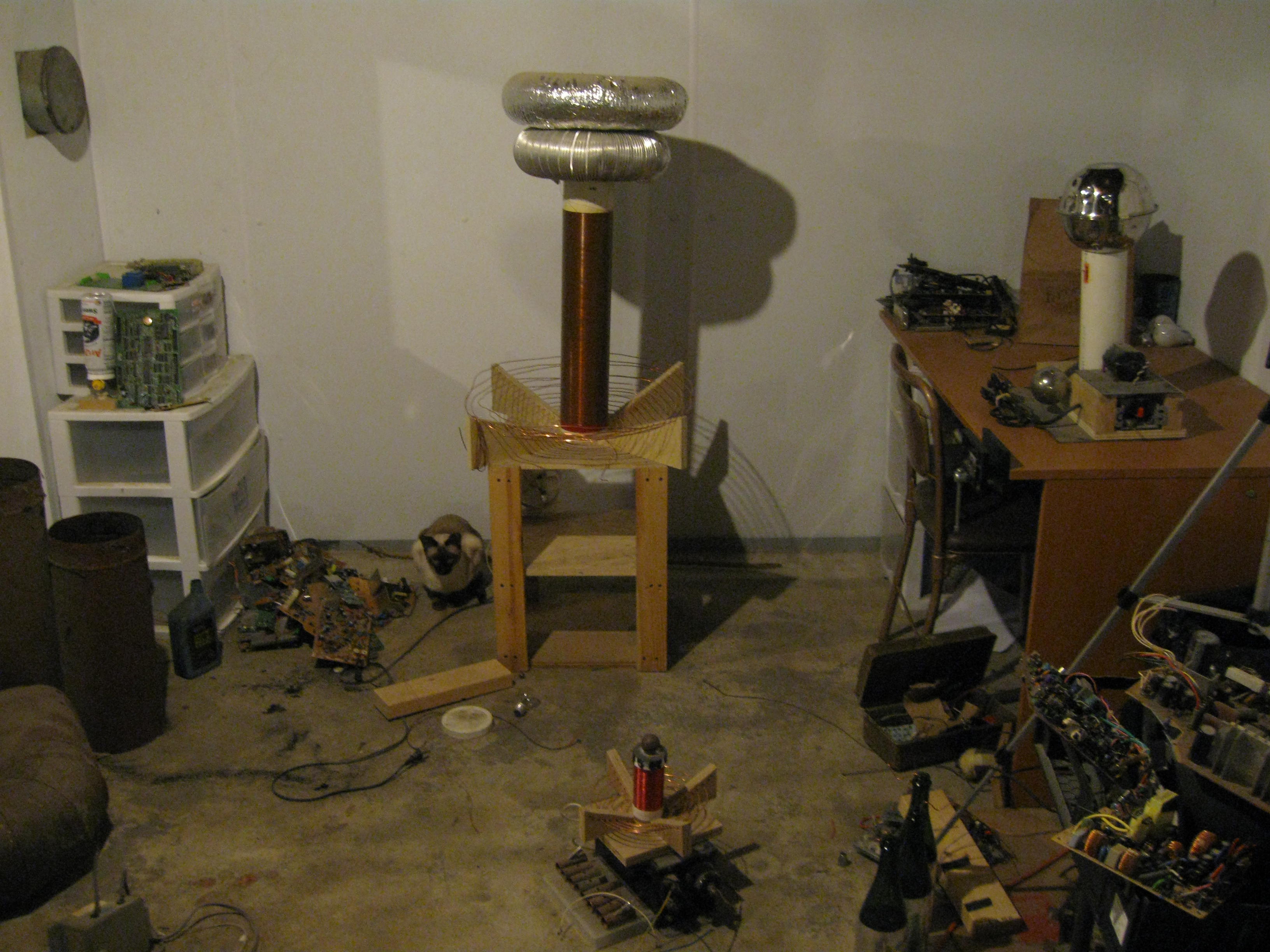

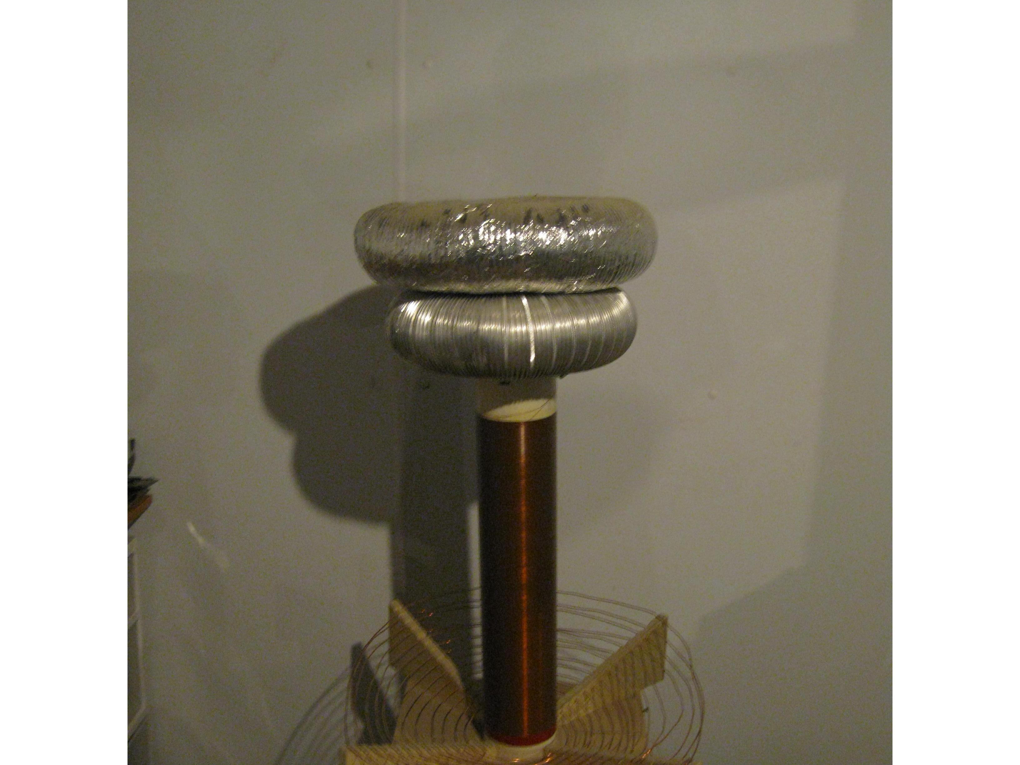

Pictures of my Tesla coil
Okay, so I told you all I would post pictures of my TC, so here they are. This is just the basic setup, minus the transformer, spark gap, fan, and (of course) the capacitor:
And yes, that's my cat lying next to the Tesla coil in the first photo :D
