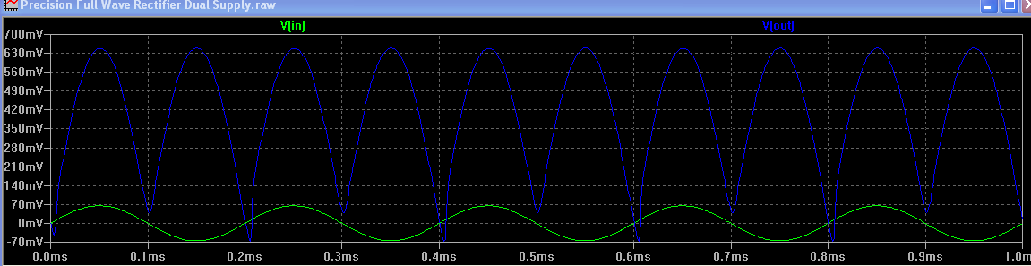

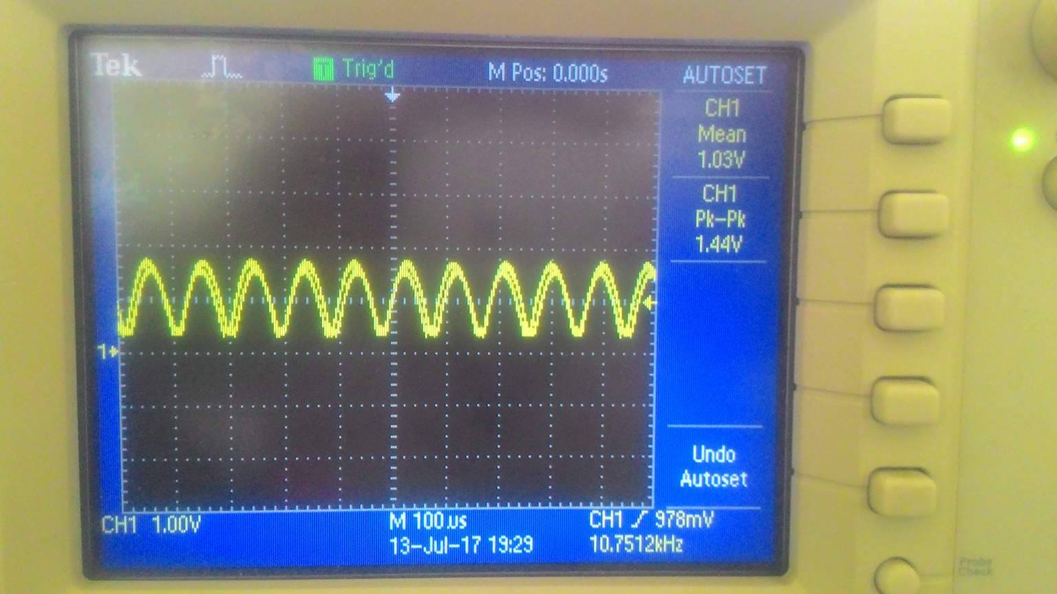

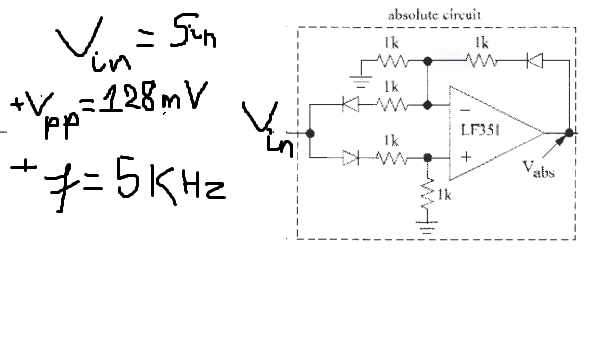

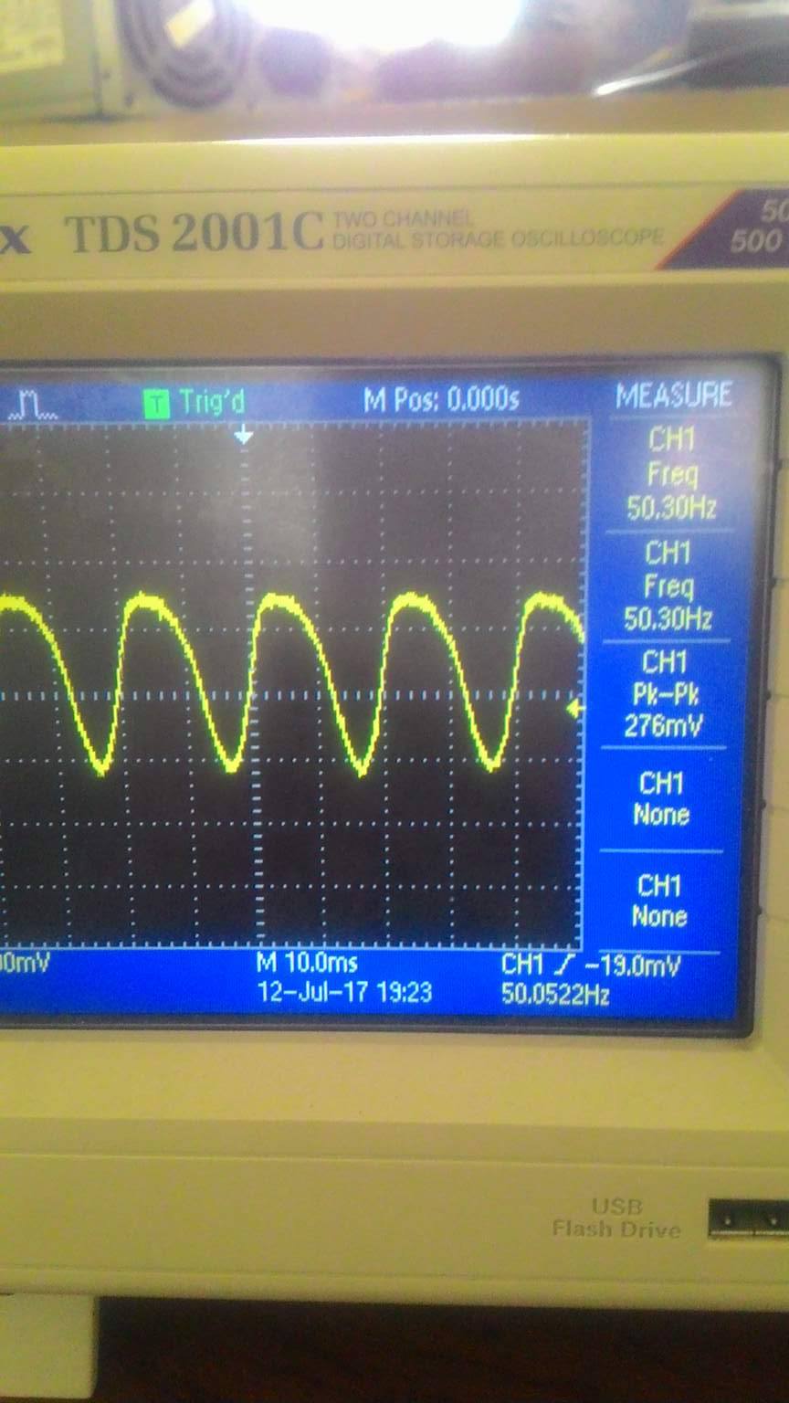

Hi Guys, As I knew : Vout of Absolute circuit must be FUll WAVE and Vout 's Frequence is equal to Vin is 5Khz. But real result is wrong ,you can see three of pictures that I have attached in below and give me your opinion, please Thanks you !

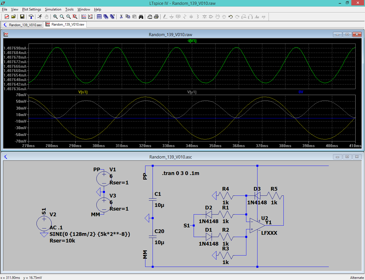

the LFxxx OpAmp seems to start working somewhat from ±6V (12V TOT) supply !!! applies to buffer for Vin = (Vdd - Vss)·(1/2)·(1 ± 1/2) !!!
your thing (as on .PNG)
Random_139_V010.png -- it does not like much frequency at this input amplitude , there's still some phase-shift detectable for bare eye at 5kHz/256 = 19.5Hz
some alternates ::
Why does the 'scope show an output frequency of only 50.3Hz? Then its input frequency must be 25.15Hz
Looks like you are picking up 50Hz main's noise.
What are the op amp supply voltages?
That's a poor absolute value circuit as the two input diodes are not in a feedback loop and thus attenuate the input.
With that design you need at least 500mVrms to get any output.
Suggest you look for "precision" full-wave rectifier circuits.

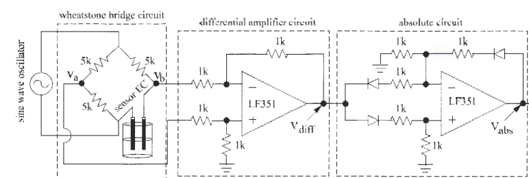

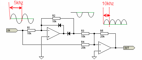

Supply voltage : +/- 9v.... I am measuring Electrical Conductivity of Solution so Vin is either positive or negative. Could you see attached file below ? That is EC circuit and Give me your opinion , please .
The opamp circuits in your design have no voltage gain and the diodes attenuate the signal so the sensitivity will be very low.

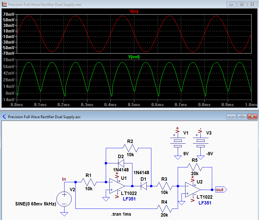

As I stated, for that absolute value circuit you need at least 1.4Vpp signal at it's input so you will either need to go to a better absolute value circuit, such as ron showed in post #7, or you need to add gain in the differential circuit by changing the feedback resistor and the resistor to ground to a higher value.
I recommend you go with ron's circuit, as the one you have is not a good design.
Below is the LTspice simulation of that circuit:

Although it is "working", I would still use Ron's circuit.
The circuit that you have shown has two diodes outside the feedback loop, and utilizes a third one in the feedback loop in a feeble attempt to compensate for that.
Unless all three diode currents are perfectly matched, which are not since the impedance looking at V(+) is different from that of V(-), you will get the artifacts that you show in your scope waveforms.
