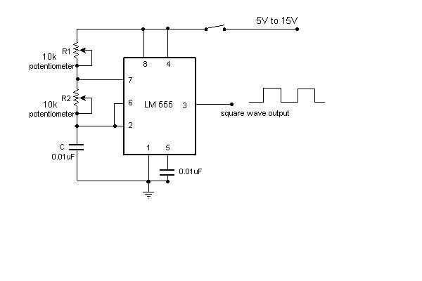

Hi guys,
I am using a 555 timer to create a 40kHz output signal. I have manage to generate that easily with a circuit built based on guide I found on internet, connecting with 2 resistor and 2 capacitor. But the problem that I found with that timer is that the output frequency of the circuit is changing with the supplied voltage. The supplied voltage range for the timer is 5V to 15V, and when I supply the voltage outside that range, the output frequency changes dramatically, which should be normal, but when I change the supply voltage between 5V and 15V, the output frequency still changes a bit, which I find is odd (When I supply 5V and tuned it to 40kHz, and increase the voltage slowly until around 15V, the frequency will increase till about 42.5kHz, and in my application, I would like it to be fixed at 40kHz). I thought it should not do that when it is running normally in its voltage range, as in, the output frequency should not be affected by the supplied voltage. I would like to ask, is that normal that the frequency will change even in its supply voltage range? Or it is just some fault with the circuit or my 555 chip? If it is normal situation, could you guys explain a little bit more in detail why is that so?

Post your oscillator circuit. I want to see what you are doing in the timing network.
The 555 timer isn't known for its stability and some ceramic capacitors change their capacitance as the voltage applied across them is increased.
The frequency also changes with temperature. I've had a circuit I built years ago, install in my carport, and still running 24/7. Sometimes I hear a 'click' from the speakers, on warm days, I can hear a tone. Normally, I don't hear anything from it.
I have attached my oscillator circuit in the post here. The output from pin 3 will be used to drive a transducer that has a resonance frequency of 40kHz. I have tuned both my potentiometer to different values, which I can't remember now, but the output signal is 40kHz. Just that it changes with the voltage sometimes.

I would try using larger timing resistors, and a smaller timing capacitor. I would also make sure that there are 1 ea 0.01uF disc ceramic and a 10uF tantalum or electrolytic bypass capacitors between Vcc and Ground. Try putting a 47 or 100 Ohm resistor between pin 3 and your transducer, too.

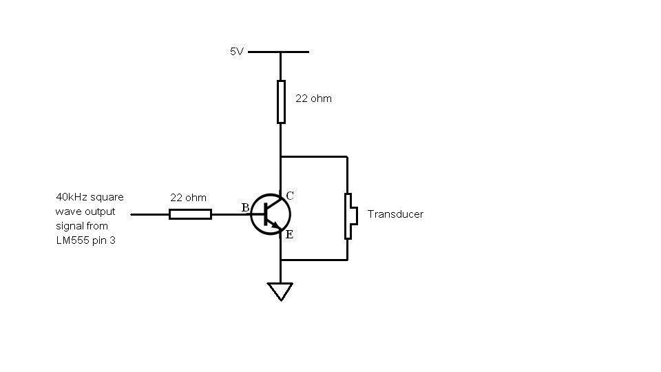

I have attached a picture of my output circuit as well, and I have a 22ohm resistor between pin 3 and the transistor, not sure is it big enough though, as you have suggested a 47 or 100ohm resistor. And can you explain further what is the reason for adding the different capacitors between the Vcc and ground?
At this stage I do not require a highly stable circuit, therefore might not be doing those changes just yet, but I am curious about how the situation occurs (Vcc affects the frequency) and how does adding those capacitors fix the problem.

The 555 is notorious for having "shoot-through" current in its output stage as the output switches high or low. If there is not an (energy storage) bypass cap across the VCC to GND pins very close to the 555 package, the inductance of the power leads can cause the voltage across the 555 to sag as the output switches. This can (and does) perturb the comparators inside the 555, causing erratic timing.
Your output stage sucks. Yes, the base resistor needs to a few hundred Ohms. The transducer should be moved between the collector and the positive supply. Does your transducer tolerate a drive voltage with a DC component, or should it be driven with an AC signal?
I have tried connecting the transducer to between the collector and the positive supply before and it doesn't work, that is why I change to this setting, and it work for me though. Could it be because of the small resistor that I used that cause the circuit not working when I connect the transducer and the transistor in series? Nope, it has to be driven with an AC signal.

I have built many oscillators with the 555 timer. I agree with MikeMI about the filter capacitor between pin 8 and ground. Also the 0.01uF capacitor from pin 2 to ground should be a good quality film capacitor. I also always make sure that the resistance from pin 7 to Vcc never gets below 1K as there can be excess current into pin 7.
Ooppss... I just checked my resistance there and it turn out to be 226Ohm and 1.428kOhm for another resistor. Before this I am using a fix resistor between pin 7 and Vcc with a value of 1k, but then I get a frequency output with duty cycle of about 70-80%, therefore I changed to a potentiometer there and tune it to get a 50% duty cycle, and the tuned value turn out to be the value that I have got there. Seems bad there, but if I tune it higher than 1k, then I might not get a 50% duty cycle anymore.
