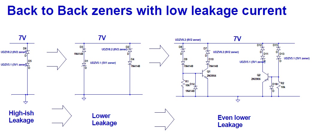

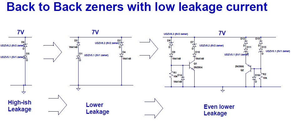

Do you think that the attached way of modifying the back-to-back zener circuit results in lower leakage current?
  • Modification for Low leakage current zeners.pdf
No, they don't. All the circuits end up with the supply voltage across the zener, so the leakage current of the zenner will be taken. The more complicated circuits have other paths which may leak, so they can only add to the current taken.

woops sorry, here is the corrected cct of post #6
I see no advantage to adding the diodes.
In either case the leakage below the breakdown voltage of the reversed-biased zener will dominate the leakage and I see no significant difference in the total leakage either way.

sorry im having a bad day..here is the correction for my post #11
Re-arranging things with the zeners can only make things worse. The zeners have leakage, so any circuit that is using them to detect voltage will suffer from the leakage of at least one zener. Other complications just add more current paths, which can only increase leakage.
Leakage reduction circuits work by turning off devices that can consume current. You can turn off the zeners, but they won't be active in the circuit any more.
