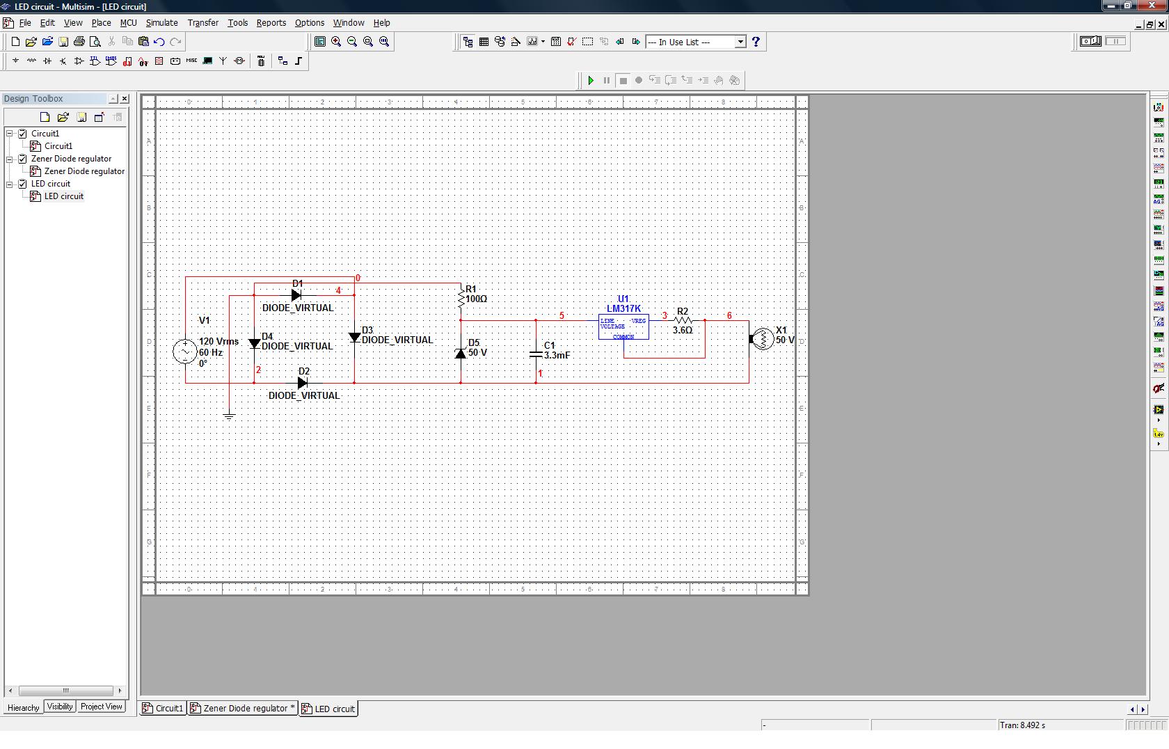

I'm looking to get around 32 to 50VDC from 110AC Cheaply..but I don't want super terrible efficiency but I'm looking for a cheaper way than an AC transformer. I'm looking for about 1.5amps. Voltage isn't critical as it will be regulated by an LM317 Later on. I did the math on bringing the voltage down with a bunch of LM317 but I'm looking at loosing 60watts by the time I hit 40-50 and Also I don't know how well the lm317 IC will take to unsmoothed FW Bridged DC. Further more its WAY cheaper to smooth the voltage after I get it down to where I need it at 50v vs 120v. Here is a rough example of what I was thinking of doing.
I'm just looking for input as to how much waster power there is just in the converting the 120AC to 50DC like this. Is there a better method that is still cheap? What sort of drain or efficiency am I looking at clamping the voltage like this?
Your LM317 also appears to be wired as a current source, and not as a voltage source. That aside...
THe DC-average of a rectified 120Vrms sine-wave is:
0.636 * 120Vrms = 76.632VDC.
And losses from clamping/linear regulation is
Voltage Wasted * Current = (76.632VDC - 50VDC) * 1.5A = 40W
THat would mean that between the resistor and LM317 you would need to dissipate 40W. Which basically means a 40W resistor since LM317's heat dissipation is almost neglible compared to 40W. You also need a zener that can handle 1.5A which is hard to find. Use a transformer between the wall and rectifier to greatly reduce this difference.
Also, having the smoothing capacitor after the voltage clamper causes the zener to constantly switch on and off (or rather, between blocking and breakdown). THat's why you have the smoothing capacitor before the voltage clamp. THe way you have it would make noise and other undesireable artifacts.
I would realy add in a transformer for safety sakes and efficiency . It's also one of the best things about AC conversion to increase efficiency so you might as well use it. Use it to to step down your AC voltage so that when you rectify the wave, the DC average is much closer to 50V which would improve efficiency of the clamp circuits and regulator.
0.636 * VACrms/n = VDC, where the transformer input : output turns ratio is n:1.
(The transformer acts on the AC voltage before rectification which is why division by n only applies to VACrms, and not 0.636*VACrms as a whole.)
A 1.4:1 or 1.5:1 transformer is about right to get close to 50VDC rectified (52VDC-55VDC to be exact) while still being high enough for the clamping circuits and linear regulator to deal with. It'd cut your power dissipation down to about 7-10W or so.
Transformer ratio of 1:2 would get you around 40V. Ratio of 1:3 would give you around 25V.
So what costs more? A 40W 100ohm resistor? Or a 100W transformer? The resistors are certainly rarer. Also consider that when when run at their power rating, resistors run hot enough to burn you and other things. One way around this is an resistor with an oversized power rating, but then you might as well spend the extra dough on a transformer and get better efficiency.
What is your load anyways? DOes it even need good regulation? Or even DC for that matter? If it didn't need regulation, that would make your life a lot easier because cooling can still be difficult at 10W.

The LM317 is indeed wired as a constant current driver for High power LED's.

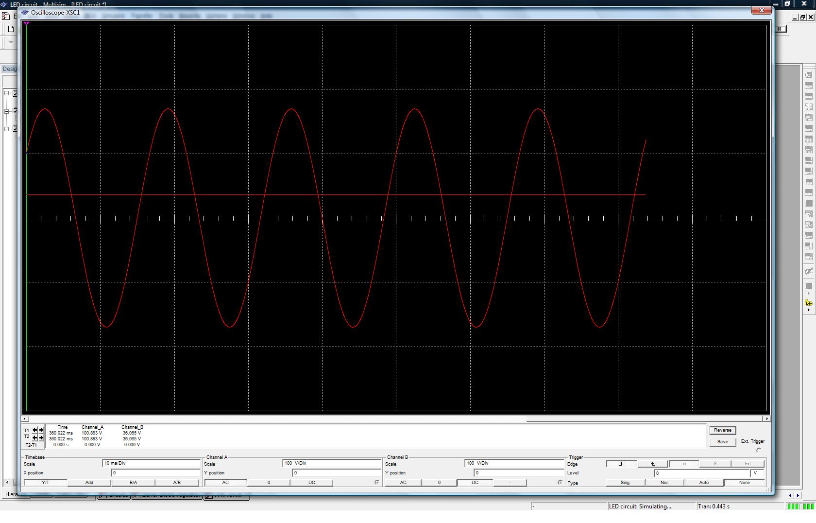

Attached is an Oscope of the DC wave VS the root AC wave. It doesn't look to me like I'd be dipping below the zener voltage at all and the wave looks fairly smooth. Am I missing something?
After looking you are right a 1.5a 50v zener is nearly impossible to find. I would have liked to get 50v. I could deal with 1 amp 36v. I just makes it so I need more 36v 1a zeners and lm317's both of are fairly cheap. I will only be able to run about 9LED off each zener/LM317 but I can deal with that.
My biggest issue with using a transformer is output. The cost of a transformer that will put out enough amperage isn't cheap. I didn't realize the resistor would have to be that large. If I didn't need the resistor then I'd be set. Anyway to do that?

WHat I'm referring to is not a matter of whether it works or not. It's a matter of the quality of the output is all. Think about it. A rectified half wave going into a zener voltage clamp without a smoothing capacitor will fall below the zener voltage every time the AC signal crosses zero. I don't know if the simulator accounts for finite time it might take for the zener to change operating modes. It's just something to keep in mind.
