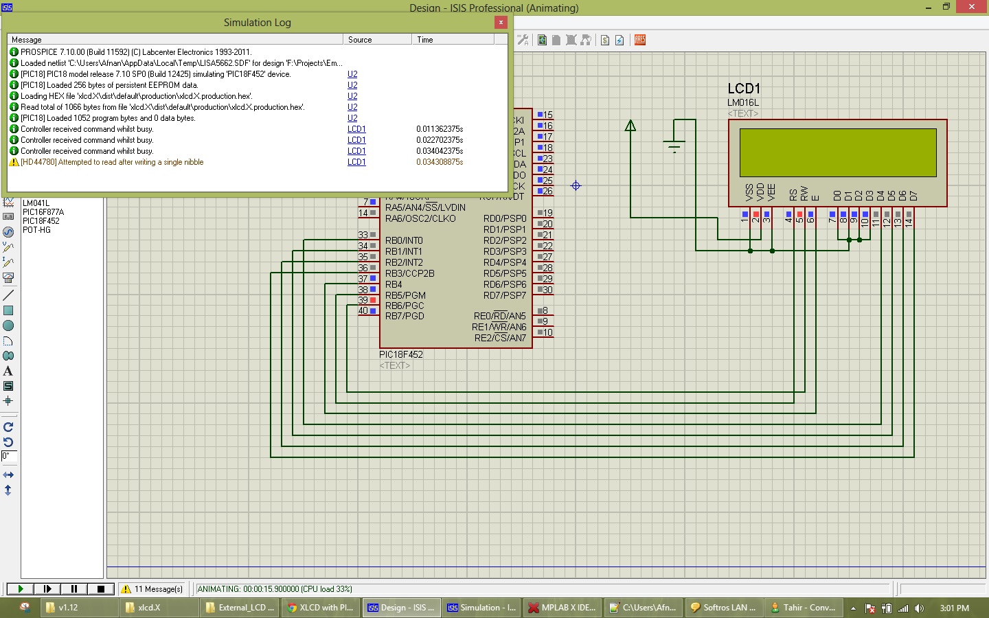

Looking at you original schematic I now realise that you are not using the LCD busy flag.
The code I posted in post #15 does require the use of the busy flag i.e. you have to have LCD pin 5 connected. Hope that didn't cause you any confusion (I expect it has though!).
Don't despair :) you'll get there in the end.

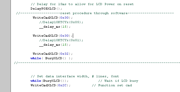

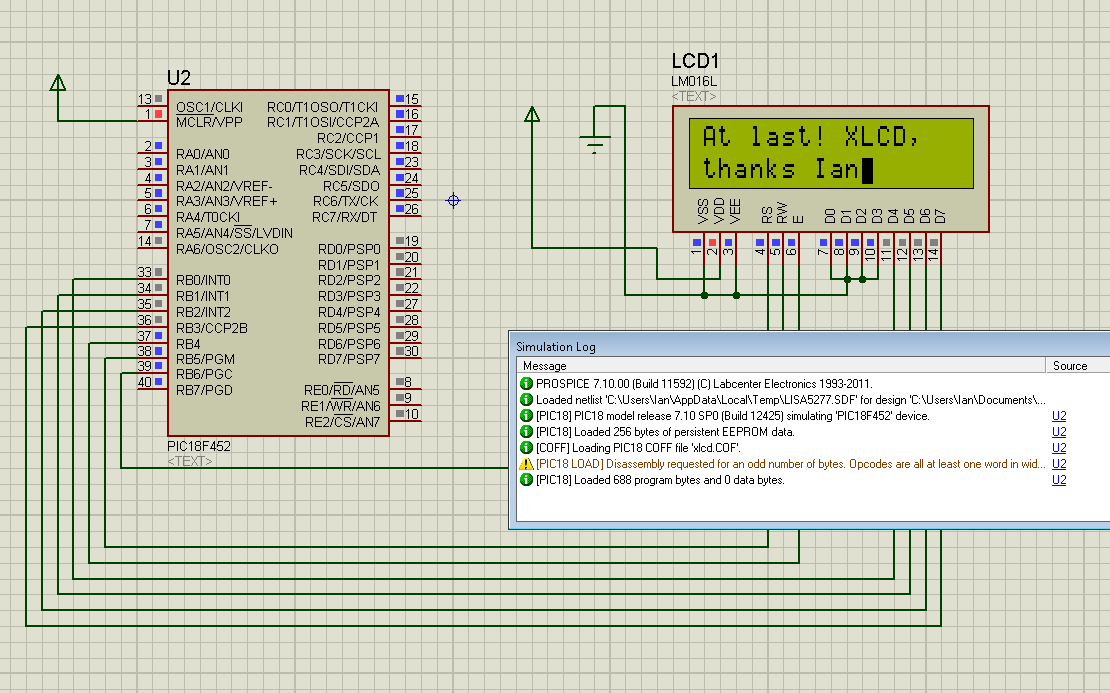

Afnan.... One or two little issues
Your DATAPORT is backwards RB0 goes to D7.....
Secondly the LCDTYPE is not selecting two lines..
Thirdly you do not need to add the line OSCCON =??? as you are setting HS XTAL...
Lastly your redeclaration of XTAL FREQ is different from the first... One is 8Mhz and the other is 4Mhz
Once you change your dataport it will work...
Even Changing Port direction and adding 0x28 inplace of lcd_type does not makes it work
LCDTYPE = 0x2C....
I have your code... AND your schematic running in ISIS....
Surely do not know what is going on. I have same files as Angry Badger. I just changed 0x2C in main file. But still nothing on lcd in ISIS. Can you send me your Project and Hex file so i can make sure that compiler is not playing tricks here at my side.
Here is the modified main.c

#define _XTAL_FREQ (8000000)    /* Not using xtal, only to make delays work as
                                    it won't compile without this */
void DelayFor18TCY(void);
void DelayPORXLCD(void);
void DelayXLCD(void);
void main (void)
    ADCON1 = 0xF;                   // No analog, all digital i/o
    TRISA = 0x00;
    TRISB = 0x0;
    TRISC = 0x0;
    LATB = 0x0;
while(1)
    OpenXLCD(0x2C);
    while(BusyXLCD());
    WriteCmdXLCD(SHIFT_DISP_LEFT);
    while(BusyXLCD());
    WriteDataXLCD('A');
    while(BusyXLCD());
    WriteDataXLCD('t');
    while(BusyXLCD());
    WriteDataXLCD(' ');
    while(BusyXLCD());
    putrsXLCD( "last! XLCD," );
    while(BusyXLCD());
    WriteCmdXLCD(0xC0);
    while(BusyXLCD());
    putrsXLCD( "thanks Ian" );
    while(BusyXLCD());
    while(1);
    __delay_us(18);
     __delay_ms(15);
    __delay_ms(5);
After changing the ports in reverse direction
RB0->D4
RB1->D5
RB2->D6
RB3->D7
RB4 ->RS
RB5->EN
RB6->RW
with above these it still did not worked. I also tried to do one more thing that copied files(XLCD folder with all C and lcd.h file too) to project directory. On ISIS i got some warnings as shown in image
I wonder why am i so unlucky..........
I Also Managed to run another opensource library. It showed perfect output at ISIS. When i write it to controller it does not show anything just straight boxes. Ofcourse this means that lcd is not initialized or something. It points that something is wrong with the hardware right? but No, Why? because of following reasons
1. With LCD i also toggle ports and thy do toggle.
2. Checked Connections multiple time with connectivity meter too
3. I wrote simple lcd test program at same pin connections it works like charm(Just ground the RW pin of LCD) .
The confusion is if the Proteus is showing the correct working LCD program it should replicate on hardware. What are my possible directions to dig into this issue? Ofcourse this is debugging but i have done what i knew you guys may help me debugging.

Guys i really need your help
Hi Afnan & Ian,
Could we just clarify something? Afnan, is your hardware circuit exactly as shown in that schematic in your very first post?
If it is then you have to be sure to use code that does not check for the state of the LCD busy flag. The code should use a delay instead.
Alternatively connect your circuit as shown in the schematic in Ian's last post.
For what it's worth, I built another little circuit using a PIC18F4520 which is to all intents and purposes the same chip you are using, except this one can run of an internal oscillator. I again used the third party code you provided in post #17 (because this code works without polling the LCD busy flag). Additionally a 'pot is used to adjust the LCD contrast.
Don't go searching for more third party library's, all the code you require is already here in this thread. :)
I sincerely apologise for spelling your name incorrectly! It's late now, I've been up since 0430, been and done a b*****d 12 hour shift and just want to go to bed now - so not going to retake the photo :D

RB0->D4
RB1->D5
RB2->D6
RB3->D7
RB4 ->RS
RB5->EN
RB6->RW
The problem is that i am sure there is nothing wrong with the code. The same exact code (replacing delays with Delay_ms and us respectively) in mikroC gives perfect output at ISIS and Hardware where as compiling the code at MPLAB 8.9 with XC8 compiler gives the hex that runs only on ISIS.
I am a bit confused now. I have been struggling for it more than two weeks
Dear Angry Badger,
I have just tried your code on post #15 by using a PIC18F4685 with XC8 compiler, however I can only see the first line "At last! XLCD,".
The second line is empty.
In the code I can see that you use 0xC0 to change line and then you write "thanks Ian".
I believe my hardware configuration is correct.
Does anyone know what should be the problem here?
Oh dear... You have moved onto the XC8 compiler.... The code posted was originally targeted to the C18..
I have given you C18 code..... I'll have a go at it tonight... I'll post a library that works with XC8...
Portability Ian? What is that?
Wondering what could be wading through all this ....:(..................................................:arghh:
Dear Ian, thank you for your help.
I am using the code that Angry Badger just posted with 3 files: XLCD Main.c My_XLCD.c and My.clcd.h.
By adding these files to a new project I just programmed my PIC and that's it. Should I change something? I did not found any option to activate a second line. Could you please guide me through?
Angry Badger hasn't posted XLCD routines... These are the built in routines... The routines above are written ( I suppose ) by him..
Can you post me a schematic and you code, Then I can see what's going wrong..
Dear Ian,
I am sending you the complete project in MPLab X. I hope you can help me.
Best regards.
