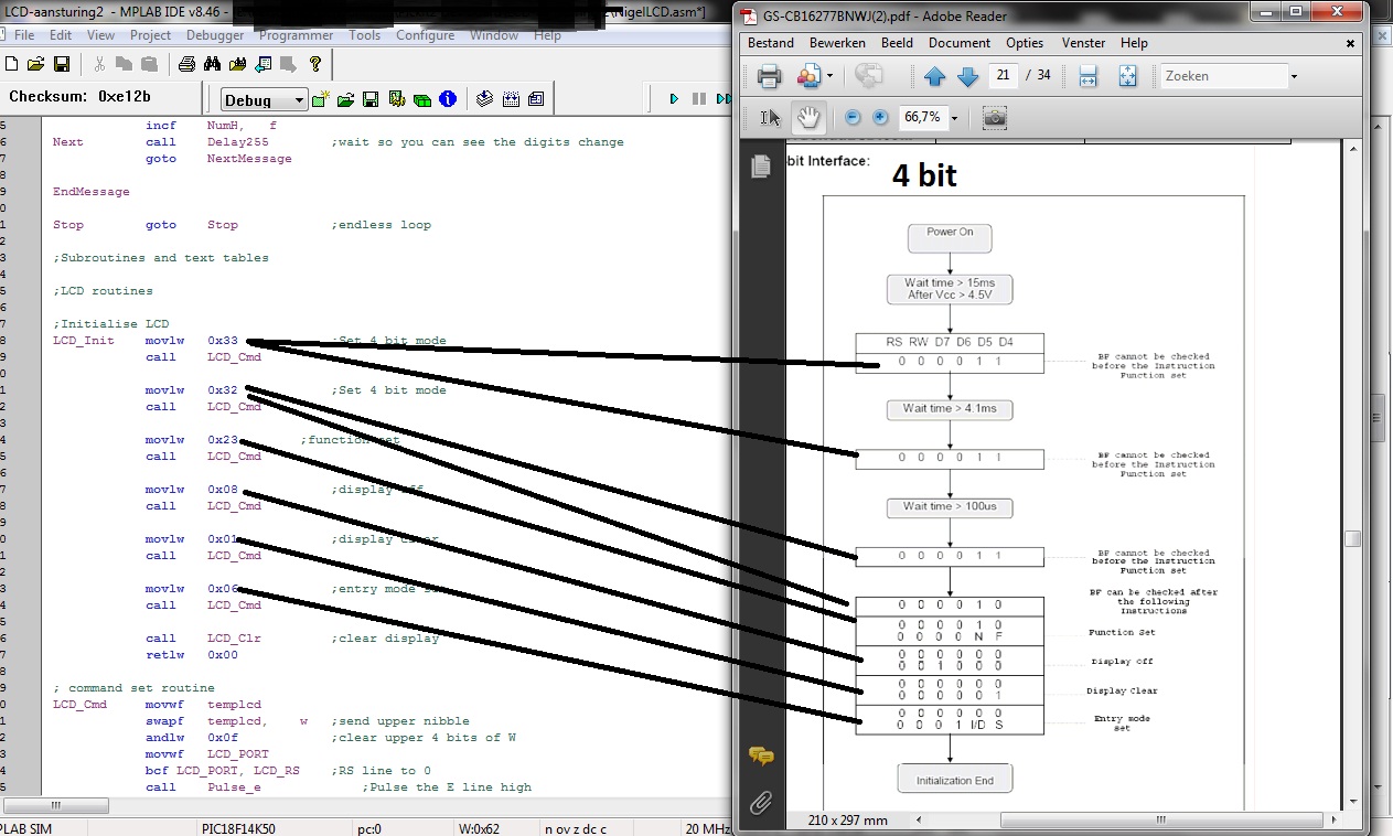

Ive got the LCD initialized in 4 bit mode . I first send the high nibble and then the low nibble , but when I look at my display I get other characters :s. I send a S and I get a J , I send a +- and I get a 2.

Like I said above, check the bit patterns, write them down above each other in binary.
I've told you twice what to check, but you don't seem to have bothered?.
Here are the binary values of the two letters you mentioned, from which it's immediately obvious that the right hand bit of each nibble is coming out as zero, when it's supposed to be one. Find out why that is!!!

Hello , I'm trying to enlarge my knowledge about ASM. I try to make my own program because my LCD is NOT the Hitachi HD44780 ,, I have the ( ST7066U)
I'm converting you program () into my LCD standards !
Which is compatible with the HD44780, as almost all text LCD's are.
Do it the other way, convert your hardware to match the code - my connections were specifically chosen to make the code easy whilst only using a single port.

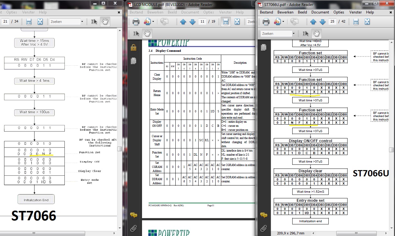

Thanks for the PDF , thats the 3rd PDF I have about my LCD :D.
Well I don't have a PIC16F , nether a board to program it . My LCD is fed from the same supply as my PIC. I"ve compared the ST7066 and ST7066U Data sheet.
View attachment ASM 4 bit.txt
I initialized my LCD by following the LEFT PDF , when I programmed the LCD I get weird marks on the display even after the command clear display. Then i tried to swap that NF ( like RIGHT ) the and I got the same , but now I have a cursor at the start and still those weird characters on my display.
Remark that I don't use the upper nibble of PORTC .

I think the problem is at the moment you have too many unknowns in the project, it would be wise to take a step back and get a known LCD program working, at least then you can be confident that the LCD hardware works.
All the data I have read states that the ST is compatible with the HD, LCD, except for some additional character memory.
Did you find why it was originally sending zero instead of one for the right hand bit?, if you have a hardware problem that could be preventing it initialising.
Presumably you have a contrast pot, and are adjusting it correctly? - incorrect setting of that will produce solid bars.
If you've got two black bars that's the most likely cause, not initialising usually gives just a single bar.
