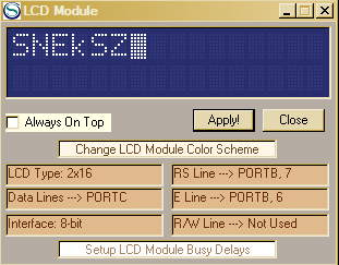

I changed the include file in your listing to 18F452 so that I can run it.
Without any other changes I get an LCD display as shown in this image from the Simulator.

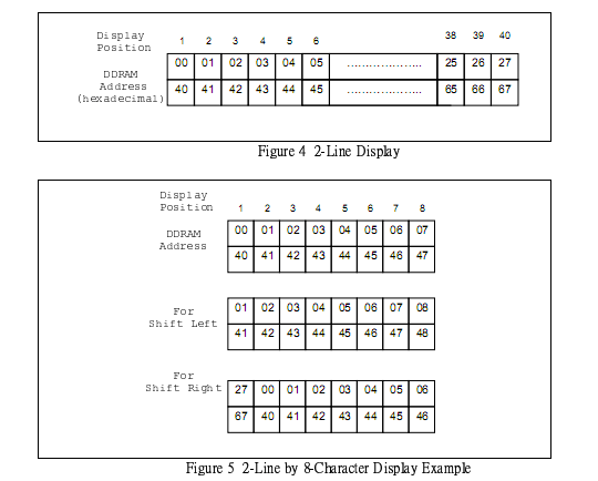

The d/s you posted today, does show a 80 * 8 data RAM.
I don't even know what that means . Can you tell me how to store the data into those ram addresses?
I think I have to set the DDRAM address and then move data to the datalines so the data is stored?

Its a 2 line display, 1st line has 0 to 39 and second 40 to 79 RAM locations for the characters you write to the display.
Look at this clip from the d/s.
