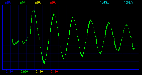

I’m investigating using the open circuit voltage of a small PMDC machine to measure the input speed to the shaft. The actual project relates to measuring the speed of a swinging pendulum.
The PMDC generator is connected to the rotating hinge of the pendulum and the open circuit voltage of the generator is recorded using a data logger. I’m getting the expected output as shown below but I’m not sure how to convert the voltage to the speed.
I know Voltage Speed, but I’m not sure how to calculate the other parameters using the information I have to complete the equation and make the speed the subject of the equation.
I’m using equations for separately excited DC machines from a book “Electric Machinery Fundamentals” – Stephen J. Chapman.
From the equation Ea = Vt – IaRa where Ea is the internal voltage and Vt is the terminal voltage, I’m assuming that open circuit voltage (which is what I’m measuring) is equal to the terminal voltage as no current will be flowing. If this is true then Ea = Vt.
Ea = K’Φn where n is the speed. Can I work out K’Φ and from the information listed below? Or by using it as a motor can I work out the values?

You have consistent sped to voltage readings, that's all you really need; I'd try spinning it with an electric drill, slow enough to count the turns & time with a stopwatch, to cross check the generated voltage - but it's probably only a few percent lower, if it is a well-made motor.
If it's a lot lower or nonlinear you need to create a graph and interpolate.
Tachogenerators are usually rated as volts per thousand RPM or millivolts per RPM.
(If you get a significantly different reading, scale that to 1000 or to 1 RPM and recalculate).
Scaling your readings, they give 83.3333' volts per thousand RPM or 83.3333' millivolts per RPM.
That's 83.3333 mV for 360 degrees per second angular rate; 231.48 microvolts per degree per second.
