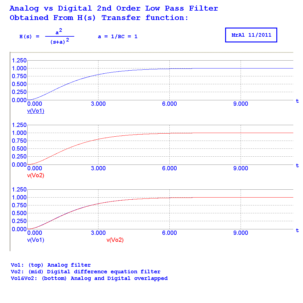

First we'll do a difference equation. This one will be for a 2nd order low pass filter derived from a 2nd order analog low pass filter with two R's and two C's, and an amplifier with gain of 1 in between the two RC sections. This makes the transfer function:
H(s)=a^2/(s+a^2) where a is 1/RC, which is easy to work with.
First we have to transform the transfer function into a digital form. To do this, we will use the Bilinear Transform which is:
(2*(z-1))/((z+1)*T)
Note that there are variants of this transform but this works ok so we'll stick with this for now.
Step by Step:
Each sub RC section is H1:
H1=a/(s+a), a=1/RC
The 2nd order filter is the same two RC sections convolved together with the amplifier with gain=1:
H(s)=H1^2=a^2/(s+a)^2
With input Vi we get:
H(s)=Vin*a^2/(s+a)^2
Using the Bilinear Transform we get:
H(z)=Vin*a^2/((2*(z-1))/((z+1)*T)+a)^2
Simplified:
H(z)=Vin*(a^2(z+1)^2*T^2)/(a*z*T+a*T+2*z-2)^2
or in sampling notation:
yn=xn*(a^2(z+1)^2*T^2)/(a*z*T+a*T+2*z-2)^2
Multiply both sides by the denominator:
yn*(a*z*T+a*T+2*z-2)^2=a^2*xn*(z+1)^2*T^2
Expand that out:
a^2*yn*z^2*T^2+2*a^2*yn*z*T^2+a^2*yn*T^2+4*a*yn*z^2*T-4*a*yn*T+4*yn*z^2-8*yn*z+4*yn=a^2*xn*z^2*T^2+2*a^2*xn*z*T^2+a^2*xn*T^2
Divide both sides by the highest power of z:
(2*a^2*yn*T^2)/z+(a^2*yn*T^2)/z^2+a^2*yn*T^2-(4*a*yn*T)/z^2+4*a*yn*T-(8*yn)/z+(4*yn)/z^2+4*yn=(2*a^2*xn*T^2)/z+(a^2*xn*T^2)/z^2+a^2*xn*T^2
Note now z does not appear in any numerator, only in the denominators, and that we left xn and yn with no z denominators alone.
Next we replace every occurance of xn/z with xn1, xn/z^2 with xn2, and yn/z with yn1, and yn/z^2 with yn2:
a^2*yn2*T^2+2*a^2*yn1*T^2+a^2*yn*T^2-4*a*yn2*T+4*a*yn*T+4*yn2-8*yn1+4*yn=a^2*xn2*T^2+2*a^2*xn1*T^2+a^2*xn*T^2
You have to be careful there to get the xn and yn correct or it wont work right later.
We get:
yn=(-a^2*yn2*T^2-2*a^2*yn1*T^2+a^2*xn2*T^2+2*a^2*xn1*T^2+a^2*xn*T^2+4*a*yn2*T-4*yn2+8*yn1)/(a^2*T^2+4*a*T+4)
Next we replace every xn with x[n], yn with y[n], xn1 with x[n-1], xn2 with x[n-2], yn1 with y[n-1], yn2 with y[n-2]:
y[n]=(a^2*x[n]*T^2-2*a^2*y[n-1]*T^2+2*a^2*x[n-1]*T^2-a^2*y[n-2]*T^2+a^2*x[n-2]*T^2+4*a*y[n-2]*T+8*y[n-1]-4*y[n-2])/(a^2*T^2+4*a*T+4)
And that leaves us with our difference equation.
Now we come to the testing phase. We'll compare this equation to the equivalent analog filter described above as H(s) using the unit step input.
First we have to calculate some values of the output yn with xn being the unit step, so we write a program...
Here is the program:
--This program calculates the sucessive values of the output of a 2nd order digital low pass filter with a unit step input.

The program allows us to calculate a lot of output values really fast, so we use that instead of doing it by hand. We could also use a hand calculate or better yet a programmable calculator. The choice is yours.
The output values obtained by the program for every 0.1 second from 0.1 to 10 seconds are as follows:

To compare these to the analog filter, we could derive the time equation and calculate the values up to 10 seconds, or we would use a circuit simulator. We want to plot anyway, so we use a circuit simulator for the analog and plot the values of the digital filter so we can compare. The following attachment shows the results of both the digital filter and the analog filter, and shows how remarkably similar the two came out to be.
Vo1 is the analog filter output, Vo2 is the digital filter output, and the bottom plot is both of these superimposed on top of each other to show how nearly equal they came out to each other. We can barely tell there are two traces in that bottom plot.
