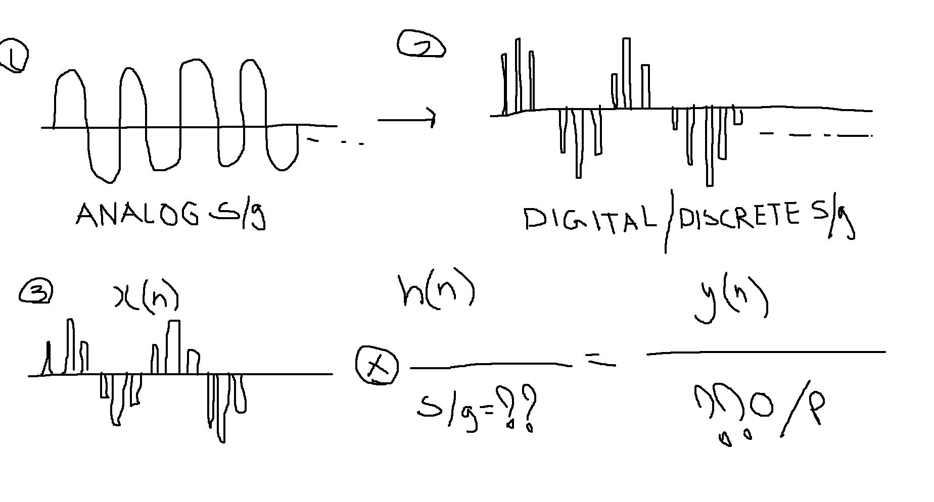

HI sir,
I am asking about impluse response...
what are these in real?? can you provide and fig. to point this out??
As if we have impluse response of then 7 or 9 what changes will come in circuit or working that the exact question i want to know...
Again im not really sure what you are asking here.
Another way to describe the impulse response is that it is the inverse Laplace Transform of the transfer function H(s).
It's a way to characterize the circuit that allows quick analysis for inputs other than an impulse.
Hello sir,
my question is digital filters or transform use impluse response...which is discrete value.
So,, this discrete value is stored in uC for processing FFT, etc.....
So, from where or how we choose value of this impulse response and feed o uC or digital chips??
I think now ithe impulse question is clear....

Hi again,
Well one way would be to apply an impulse to the filter transfer function (we talked about previously) and record the output and code that into the uC chip.
I think you should really do a search for this on the web however because you'll find various techniques in use. In particular, look for:
"FIR Filter".
I'll see if i can get a drawing up that illustrates what this all means.

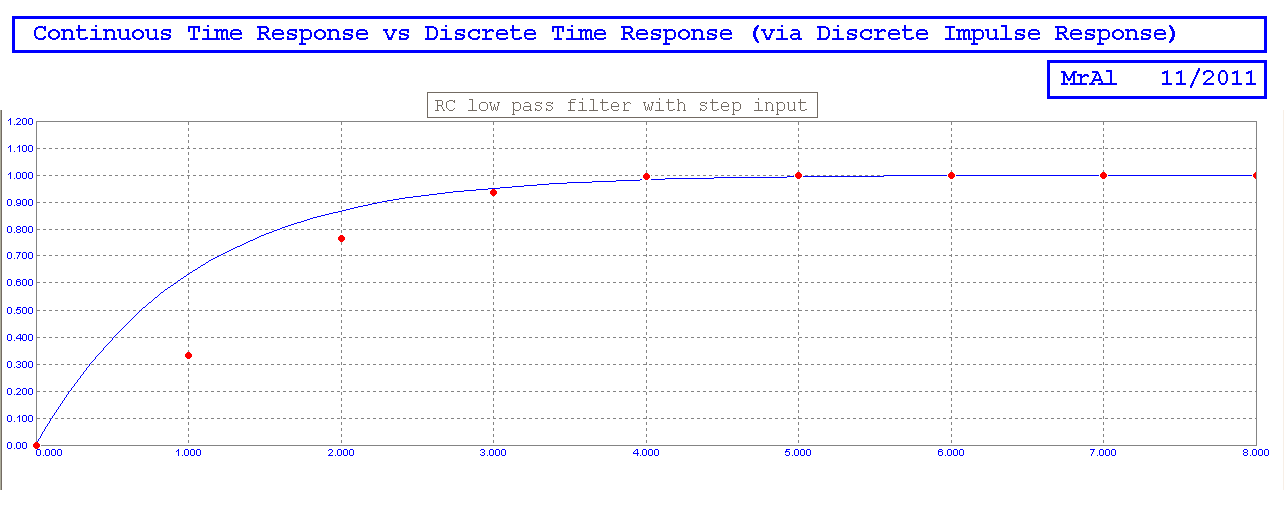

I thought it was going to take longer to work up an example, but it turns out it didnt take that long at all.
This example uses the previous example of a continuous time RC low pass filter transfer function transformed into a digital filter transfer function. For this example R=1 and C=1, and the sample time T=1 also.
Since the digital filter transfer function therefore was already available, an impulse (more appropriately called 'unit sample') was used as the excitation and the resulting output sequence recorded. Since that output sequence represents the impulse response, that impulse response was then convolved with an input step wave and the output sequence recorded. The continuous time response could then be compared to the discrete time response.
The result of the continuous time response and the result of the digital response were plotted vs time and that plot is shown in the attachment.
The blue plot is the continuous time response and the red dots are the digital response points obtained as the output from a sequence of all ones convolved with the impulse response obtained from the digital transfer function.
As we can see from a quick inspection of the two plots, the digital response is not exactly the same but it does act in a similar manner.
The impulse response (more appropriately called the 'unit sample response') was recorded for 10 points and were the following values:
0.3333333333
0.4444444444
0.1481481481
0.04938271605
0.01646090535
0.00548696845
0.001828989483
0.0006096631611
0.0002032210537
6.774035123e-005
The above could be used as the impulse response and coded into the micro controller memory.
The actual numerical data for the output is as follows:
0
0.3333333333
0.7777777778
0.9259259259
0.975308642
0.9917695473,
0.9972565158
0.9990855053
0.9996951684
0.9998983895
and those values are plotted as the large red dots in the drawing.
Hi again sir,
(I think) The graph is representing the output waveform when unit step is input while it takes some time to reach its peak value ( i.e. logic 1)
one more thing, Is impulse mean like we use AND gate and have input to one side A and sampling pulse at B of AND gate and taking output from C??
last thing,
as per fig. impulse mean discrete amplitude of sigmnal at time period of 1sec..??
That mean we first need to enter impulse in uC, can we get this impulse response seen in oscilloscope or simulation software (MATLAB)
The graph is showing a regular RC network with a step input, and the sampled data filter output (red dots) with step input after we found the 'unit sample' from using the bilinear transform on the continuous time system. See below for more on this.
Which brings us to some small terminology difference...we should be calling the digital response the 'unit sample' response rather than the impulse response as that's more correct. You can find the response of your digital filter by using a unit sample input and recording h(h), the output. The unit sample is applied at t=0.
Really we refer to the values as 'samples' but they are like impulses with a given height, and are usually drawn as dots at the required place with a line that extends from the dot down to zero. So they look like little lolly pops :) They are defined only for that sample time.
If you wanted to see the unit sample response (to be coded in uC) on the scope, you could input a unit sample at t=0 and watch output on the scope. It will go though various transitions and usually the sample will last the whole time period rather than for just one instant so keep that in mind.
To see the impulse response of a continuous time system, you could use a step input and a fast, scaled differentiator on the output. For example an op amp differentiator with time constant 1ms would be scaled 1000 to 1. This assumes a linear transfer function.
More on the digital low pass filter example...
Note that the output can be obtained by adding successive values of the unit sample response. This gives rise to another idea that seems to work very nicely.
The idea is that we apply a step input to the low pass filter, sample it's outputs at several sampling intervals, and use the difference between samples as our unit sample response. Interestingly, when we do it this way and we convolve it with a step input we get the exact output as we would from the continuous time system except the output is a set of samples instead of a continuous wave. The values at the sample instants however are exactly the same as the continuous time system assuming no finite register length truncation.
