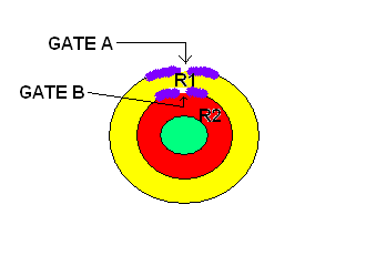

Here, let me try to explain the above program with a picture attached. In a stadium, there are 2 gates "A" & "B". Mr. "R1" is the gatekeeper of gate "A" & Mr. "R2" is the gatekeeper of Gate "B". You are a runner.
When you enter Gate "A", Mr R1 hands you a letter and asks you to report to Mr R2 at gate "B". When you're at gate "B" Mr R2 read the letter and give you 16 apples. You have to go round the track colored in red and on each round drop one apple into a basket.
After you've run the track 16 times and finished dropping 16 apples, you go to Mr R1 through Gate "B" and get another letter with same contents from Mr R1.
This will repeat 16 times as Mr R1 only has 16 letters. So you dropped a total of 16x16 = 256 apples onto the basket. After that you exit through Gate "A" and complete the job.
That is roughly what the program is doing and it acomplished nothing except wasting time. If you want to delay more time you can either increase the number of apples on the track or increase the number of letters. Or you can add jobs to do while you're runing on the track like this:
