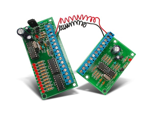

velleman kits do a 2 wire 10 input and 10 relay remote system fairly cheap.
