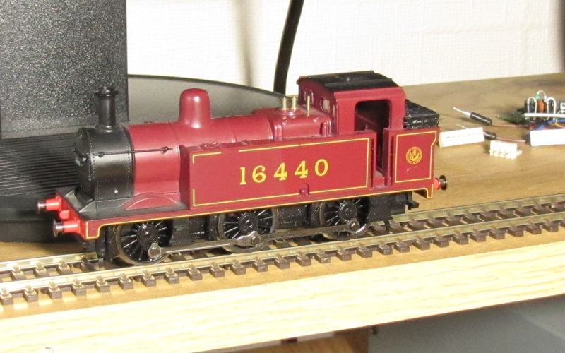

I am experimenting with a small model train trying to produce realistic movement , I'm using a MAX14870 driver. and a PIC .. getting movement is not a problem , but as I expected , slow speed is rather random (and whistles) with a short PWM value.. It is just a square signal at the moment , any ideas what can be done to obtain better results..... perhaps a ramp. a bias voltage or different signal ..

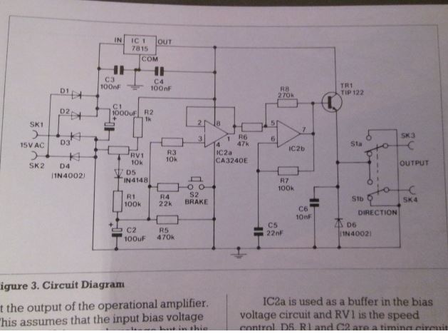

Have you seen this very old Maplin project which seems to offer what you need.
We did build it many, many years ago, it did work, but cannot remember how good the low speed was, but it was not that bad otherwise we would have scrapped it.
Operates on a PWM, though the text does not mention what frequency.

Many thanks WP100 .. I have the 4 channel controller built and being developed. Each train has its own command decoder, driver, address and name to identify itself to the controller, projected system will not be limited to the number of locos, signals, points etc ...Currently I am trying to get a realistic motion , both to accelerate and decelerate and save this to a profile for that engine in the controller memory (dsPIC33EP512GM304 and 24LC256);
Think need more track I only have 1 yard length and one engine ! wish i had kept all my Hornby stuff from 50 years ago ... ..
