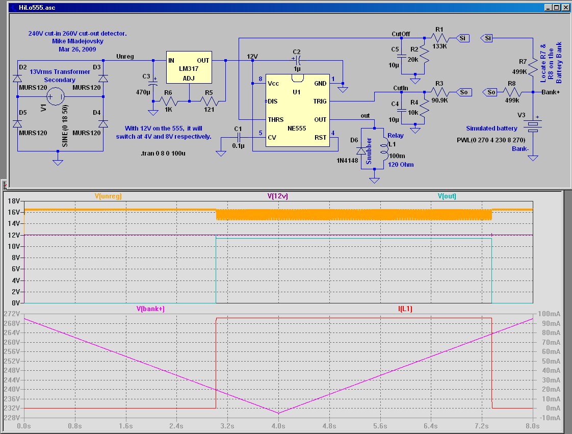

Here you go. I used a LED as a temporary load. You can use a small relay. I would put a snubber diode around the relay coil. If you want it to be ON when the LED is OFF, you can return the other end of the relay to 12V instead of ground. Use a 12V relay with a coil resistance greater than about 100 Ω

If a 120Ω relay coil is connected between pin 3 of the 555 and ground, and pin 3 is HIGH, the 555 sources current from pin 3 through the relay coil to ground, actually about E/R=12/120=0.1A=100mA. If a diode parallels the relay coil such that the cathode end is at pin 3, then the diode is reversed biased by ≈12V, and only reverse leakage current flows though the diode. If pin 3 of the 555 is LOW, there is 0V across the coil and the diode, and no current flows through the diode. Look at the revised schematic I'm posting in my next response to vielle568.
The only time any significant current flows through the diode occurs just as the 555 switches from HIGH to LOW. Without the diode, the inductive spike from the relay coil would try to drive 555 pin 3 to a negative voltage. The diode clamps that voltage to no more than -0.65V (forward conduction voltage of a Si Diode).

Just to be clear (ala Omaba:p), when the battery voltage is ≤ 240V, pin 3 of the 555 goes HIGH, and the relay pulls in. It stays pulled in until the battery voltage ≥ 260V, at which point pin 3 of the 555 goes LOW and the relay drops out. Look at the updated simulation I have attached.
I updated the diagram to reflect some of the issues we have been discussing. Note the size of C3. With 13Vrms on the transformer secondary, if this capacitor is smaller than 470uF, the unregulated voltage sags below the dropout voltage of the LM317, and there is much ripple on the 12V line!
This depends on the resistance of the 12V relay. If your relay's coil resistance is higher than 120Ω, then C3 could be smaller.

Thanks for the revised schematic. The circuit I've built is exactly the same except that the relay I have is only 6v and so I have pin 3 connected to the base of a transistor that triggers the relay at a lower voltage. Yes, it all works. The capacitor for the LM317 is 1000uF so it should be OK; the voltage is up at 12v and the relay toggles alright when the power is turned on.

Well the 555 circuit is finally in place in the wind turbine controller. It seems to be wired up correctly because there were no sparks or explosions today. The voltage division resistors are mildly warm, but apart from that nothing else is getting hot or smoking. It's mounted in a plastic case just to be safe; the trim pots are mounted on the side with knobs attached. At the moment the relay is pulled in keeping the load (the house) tied to the inverter/battery bank. There's a fair amount of wind here at the moment and so the batteries keep on charging. I can't say if yet the new circuit triggers when the batteries run low on energy.
