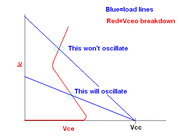

Roff do you know why the design uses so much small resistor? 1K it was impossible to make it work but it worked fine with a 47K at 12V
It is a function of where the load line intersects the VI curve of the Vceo breakdown. The red line below is representative of the general shape of the Vceo breakdown VI curve. The blue lines are examples of load lines that will and will not oscillate. As you can see, in order for oscillation to occur, the load line has to intersect the breakdown curve in its negative resistance portion. The one that doesn't oscillate intersects the positive resistance portion of the curve, and is therefore a stable bias point.
In simple terms:
The oscillator needs to satisfy following conditions to oscillate:
  • The supply voltage needs to be high enough for the transistor to break down.
  • The series resistor needs to limit a current to a low enough level to allow the transistor to turn off after the capacitor has discharged.
It won't oscillate if:
  • If the resistor is too low - the transistor will just remain on after the capacitor has discharged as the current through it will be high enought to keep it conducting.
  • If the power supply voltage is too - the transistor will never break down.
