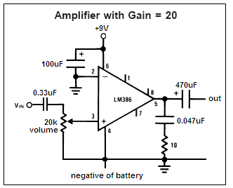

hmm... i got this LM386 IC for power amplifier circuit to drive my loudspeaker..
From the datasheet, i can see the circuit with 20 gain. I juz wanted to confirm does the output from my wien bridge oscillator is the direct input to the pin 3 of the IC such as the circuit shown?
Mneary: sorry, my theory is very weak, explain more?
Your oscillator has an output voltage of about 2V peak-to-peak. If it directly feeds an amplifier with a gain of 20 then the output will try to be 40V peak-to-peak. The max output voltage of an LM386 amplifier that has a 9v battery is 6v peak-to-peak so the output will be extremely distorted into a aquare-wave.
Use a volume control in between to reduce the output level so the LM386 does not clip the signal. A coupling capacitor must feed the volume control.

if i'm not using battery, but using DC supply or 9V to the LM386. Is it applicable.
plus i tried audioguru cirucit, i can only get my output till after the 0.33uF capacitor. After the 20kohm ressitor, i cant get any waveform at all....wat is wrong?

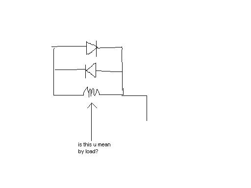

what u mean by load?
is my circuit have an highpass filter?

For audioguru's circuit, if i need to vary the gain, what should i do with the circuit? Ex. a potentiometer ??

9V from a 9V battery is exactly the same as 9V from a power supply.
The 0V (ground) of the oscillator must be connected to the 0V (ground) of the LM386 amplifier.
There is no 20k resistor in the LM386 circuit. There is a 20k volume control that can be turned to give from nothing up to the full signal from the oscillator to pin 3 input of the LM386.
If the volume control has an audio taper (logarithmic) then it will work best when set to about half-rotation.
Turn the 20k volume control to increase or decrease the output.
The 20k volume control is a potentiometer.
Ground 0V from the oscillator, do audioguru refer to the circuit i use, or the circuit audioguru suggested? because i'm using my circuit for the wien-bridge, and i finally get a beautiful sinewave.
I now stuck at whereby i had constructed the circuit as as shown by audioguru for the amplifier, the only place differ is the 10ohm resistor where i replace wif 27ohm because i cant find any 10ohm around.
I take the output from pin6 of the oscillator and connected to the 0.33uF and i didnt see any outputs.
The LM386 amplifier doesn't work unless the 0V of the oscillator circuit is connected to the 0V of the LM386 circuit.
10 ohms is recommended by the manufacturer of the LM386 to prevent it from oscillating at about 300khz. Go buy one.
Are the 0V connected together/
Is the volume control wired properly?
Is there a 6V to 9V supply for the LM386?
