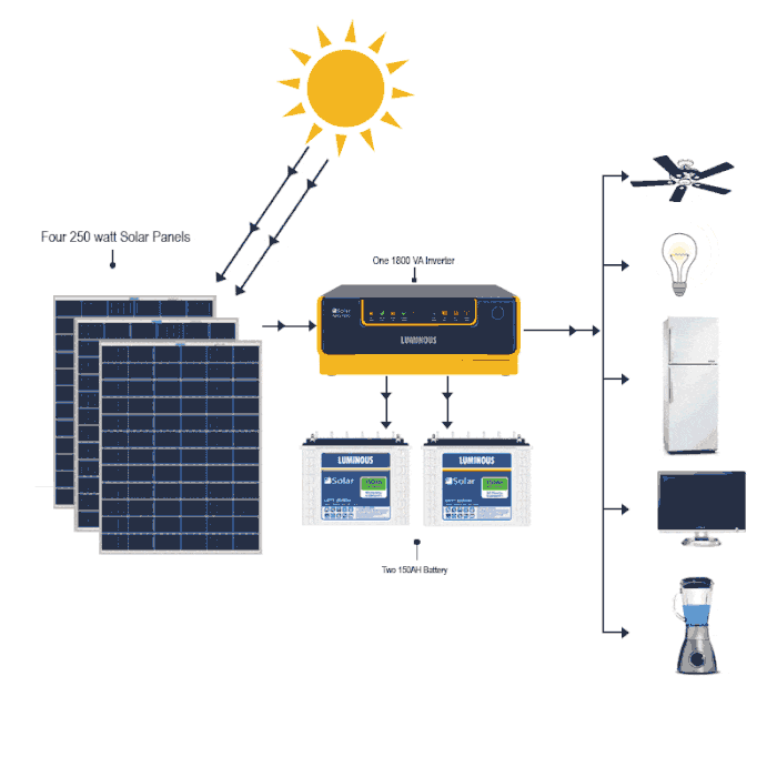

I have seen in the solar power system panel that the system may have both a battery and an inverter.
I do not understand why they do not use only batteries or inverter why they use both inverter and battery
Hi.
The items on the right column prefer to work with alternating current. That is provided by an inverter. The items at the right column may need to operate at night, possible when panels are not productive but their daylight production was stored in the batteries.

I think they should either use only the inverter or you should use the battery, both device store power that supplies to home devices. that's why I am confused,
As already explained, the battery stores the energy from the solar, making it MUCH more useful - and the inverter converts it to mains AC to run normal household equipment.
If you convert all the household equipment to run off the correct DC voltage, and rewire the entire house specially for that, then you wouldn't need the inverter.
No. Only the battery stores power (or more correctly energy). The inverter converts the panel DC voltage or the battery DC voltage to an AC voltage for AC loads (most mains-powered devices).
I have a question The voltage coming out of the solar array is AC or DC. I assume there will be an AC voltage
AC is created by rotary movement - there's nothing that moves in a solar panel, so as Diver300 said, it's output is DC.
nothing moves in an inverter but it outputs AC - lack of movement is not a criteria for DC.

Solar panels do not make power in the dark. Solar panels are rated for peak power under direct sunlight not shade. So while solar panels can provide power and charge batteries under the right conditions they can not store energy which is why we have batteries in the loop. If I want house lights after dark batteries are my new best friend. :)
