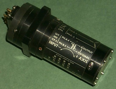

I did once run an aircraft gyroscope (400Hz 3 phase) from the output of an audio amp, using a 400Hz tone in to the amp & turning up the volume until the speed stabilised.
(A capacitor from one of the outputs to the third phase wire gave the phase shift to set the direction).
