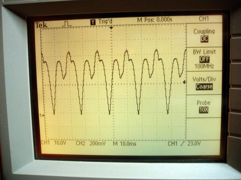

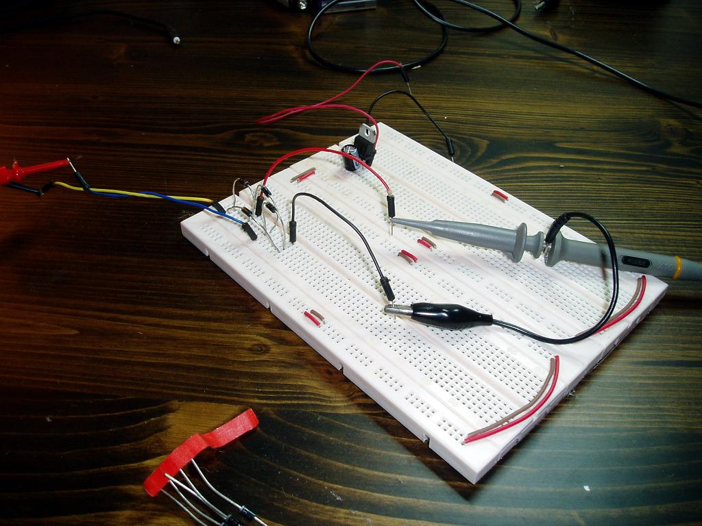

I've never worked with AC before, and after having rectified a simple 24VAC signal with a diode bridge (which looks like a perfect sine wave) i see this. Could it be the capacitance on the breadboard? The passive scope probes? The regulator and cap in the background are not connected in this case.
The signal gets filtered and regulated to 5V just fine, i'm just curious why it doesn't look like a perfect rectified sine wave.

What does the AC waveform from the transformer look like? if similar spikes appear on both sides, (the positive and negative wave) I suggest it is mains carried interference.
If not it may just be one of the diodes damaged and causing it.
Nev.
put a load on ouput of rectifier and wave should be normal, this is probably cause by capacitance of oscilloscope
Also, make sure the X1/X10 switch on your scope probe is fully in one position or the other. In the photo it doesn't appear to be fully in the X10 position.
creakndale
When the transformer secondary voltage is at its peak, two diodes turn on, and one end of the winding is at about -0.6 V and the other end is at about 0.6 V above the capacitor voltage.
You have no load when you took those measurements, so the diodes are only turned on for tiny fraction of the period. The rest of the time, the voltage is free to float anywhere within the rectified voltage range, because the diodes are off. Then what you are seeing is stray capacitance from the primary side. If you touch the circuit, the waveform will change a lot.
If there is a load, then for a larger fraction of the waveform period, the diodes will be turned on, and the transformer voltage is fixed. However there will still be times when the diodes are off and voltage is floating.
This doesn't matter at all. Most rectified AC circuits are like that.

c) lousy arrangement on the breadboard

Could also be because of the differences in diode capacitance in the rectifier diodes. Try putting a small load on the output.
Once I put a load on the output, the signal rectified looks perfect. Diver300, I will try to wrap my head around your explanation. Thanks.
