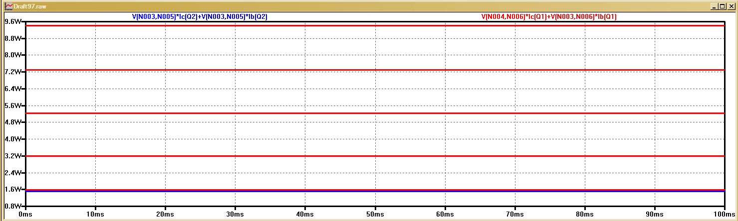

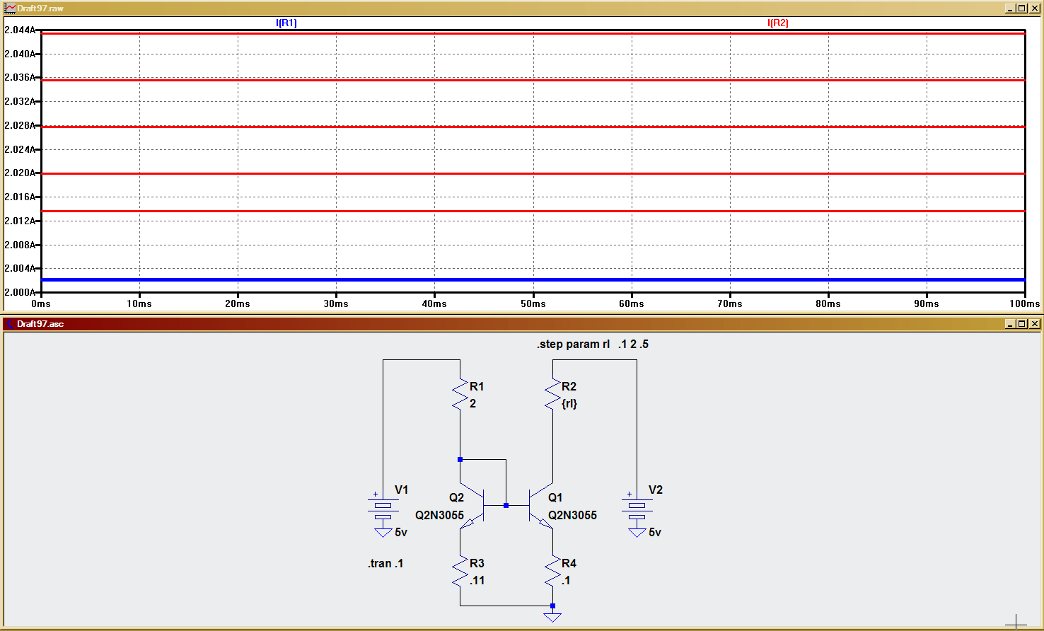

I first wanted to know if the current mirror would work. When that's working I'm going to look the the dissipation, which is also depending on the voltage over the peltier elements. When increasing the current through a peltier element, the voltage increases also, so less voltage will be over the transistor.
But I will try to make a circuit with 0.1R emitter resistors. The advantage of the Emitter resistors I can change the multiply factor of the current mirror.

By trimming emitter value you can of course improve the tracking.
As you say, a heat sink will be required.
Let us know how the mirror works in the final application.
I understand the theory as explained on the link. My simulation is working as expected. Why should I post my simulation file?
My real circuit does not work.

I also build the circuit with a PBSS4021SN, which has 2 transistors in  one package. This configuration does also not work. The current through  R3 is increasing when decreasing R3

I think too much is being made of gain (beta) mismatches. IMHO, the most sensitive parameter is emitter area mismatch, which exhibits itself as Vbe mismatch. If you want to play with this, add an area multiplier term after the transistor's name. For example, "2N3904 M=1.1" will make the transistor 1.1 times larger. In the Philips model that I have, this causes a Vbe mismatch of about 2.7mV at Ic=10mA. This in turn causes a mirror current mismatch of 10%, which we should expect, given the 10% area mismatch.
Now take two 2N3904s with identical areas, and change the beta on only one of them to 100 (nominal is 300 in the model). The mirror current mismatch simulates at about 5%.

I did a test with the two BC548 transistors. When pressing the two transistors together the current in leg two drops a little. Since the voltage over the transistor in the mirror leg is higher more power is dissipated so also the temperature is rising. With a rising temperature I see a rising current.
So it is important for the transistors to have the same temperature.
That's true. It is also important that the Vbe's be matched within 1 or 2 millivolts at the approximate current that will be passing through one leg of your mirror.
To match transistors, use the circuit on the reference leg of your mirror, and measure Vce. You will have to let the temperature stabilize before making the measurement.

The real circuit is working great, but in the simulation is the two currents are not equal!

I 'think' what the OP is trying to do, is to tap into an existing 2Amp current in a Peltier circuit in order to drive another Peltier at the same current by using a 'mirror'.?
The best devices for current sources are ones with large early voltage, Va, (constant current vs. Vce slope is small and parallel at various Ib->Ic drive levels) and good saturation characteristics (active region knee at low Vce voltage).
I doesn't take much connection resistance difference in one of the emitter legs to screw up the expected ratio. If you can stand putting in emitter resistors they will wash out variations in devices and temp. Two devices on same die with same wafer lattice orientation is best, two die in same package (most of time they are taken from near adjacent spots on wafer) is next, two parts epoxy'd together is least accurate at keeping temps the same between devices.
In simulation, check mirrored device collector current versus Vce voltage. A really good device can keep the mirror accuracy down to 0.2 to 0.4 volt Vce.
