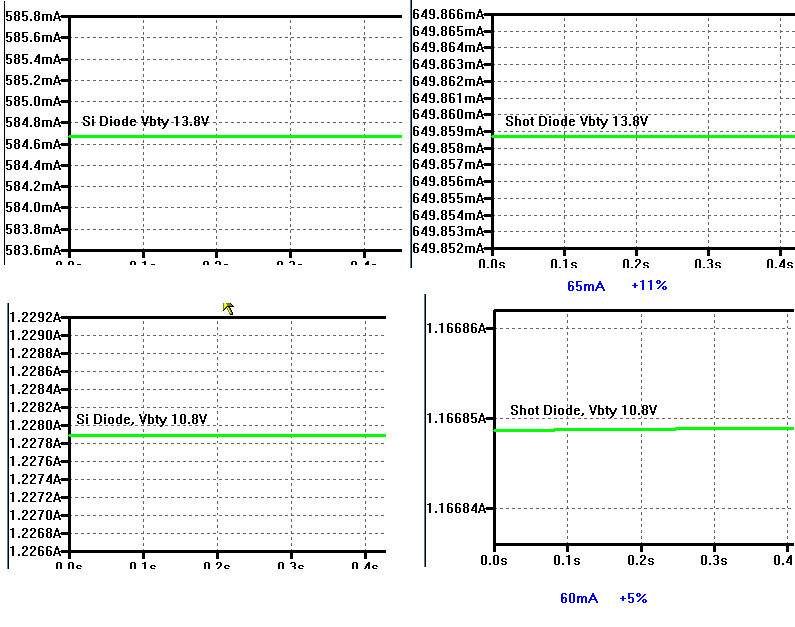

How did you work out 9%?
OK,
To cover the fully charged and discharged state of the battery,
ie: 13.8V and 10.8V, assuming for the test, the battery has an internal resistance of 0.1R
A solar cell with and emf of 17.5V and internal impedance of 5R.
I ran LTSpice simulations for charged/discharged battery, charging currents using a closest match silicon diode and schottky diode.
See attached image:
The results show for 13.8V approx 11% and for 10.8V, 5%
If you take an average, it suggests an increase of 8%.... so I was 1% high in my rough calculation.
Does this answer you.?

Ref the miniscule current, if you do the calculations for a battery charge state over a voltage range of 10.8V [discharges] to 13.8V[charged] you see that the minsicule current can be as much as 9%... hardly miniscule.
The figures you supplied suggested the impedance of the solar panel is 5R and the current difference when a diode is replaced by a Schottkey diode, will be 8%.
But a solar panel does not work as you have suggested. When a normal power diode is replaced by a schottkey diode, the voltage across the load decreases by about 0.3v and this will cause a higher current to flow. The solar panel will not be able to deliver this current and consequently the voltage produced by the solar panel will also reduce and the current will remain almost exactly the same as before.
In other words, as I said, it does not mater if you use a power diode or Schottkey diode as the "reverse current" protection.
