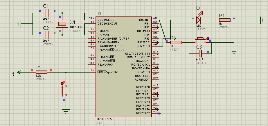

but i just connect jumper from PIC to ZIF socket with exact pin number... i got another problem when i do it on training kit it work but when i do it on protoboard/breadboard it not working. so i make simulation on Proteus ISIS and it show not working also...

Sorry, I see what you mean.
You are aware that pushed switch will give you a 0 and not a 1, correct?
Do you want it to flash the light when the switch is pressed or if it's not pressed?
You said you're receiving an error, correct? A high voltage error?

the high voltage error the one that i want to test program PIC using training kit but just use jumper from the needed pin(PIC) to ZIF socket(TrainingKIt)...
the new post is new problem... ya if push switch it will give 0 cause go to ground maybe... if i press the switch it will on the LED...
Right, I think you'll want to change that to if (sw1_pin==0).

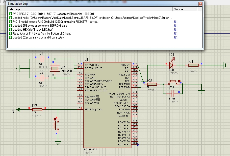

ya i already loaded the code into PIC here with simulation log :
if i put LED into pin RB0 which i code for SW1, and SW1 to pin RB7 which is code for LED... it work but got error message with logic contention detected... when i change and fix the error by put back the input and output pin to exact location, i cant even on when push the button...
Edit : i also try (sw1_pin==0) but still same...

I'm asking if you could copy and paste the error, or show a screenshot of it. All you've shown us so far is the circuit and a working simulation log.
if u asking for that high voltage error, i do not have it... the training kit is in lab, i only can go there on Tuesday and Thursday... that why i want build programmer for myself...
if from the circuit that newly i post it do not show any error but not working...
